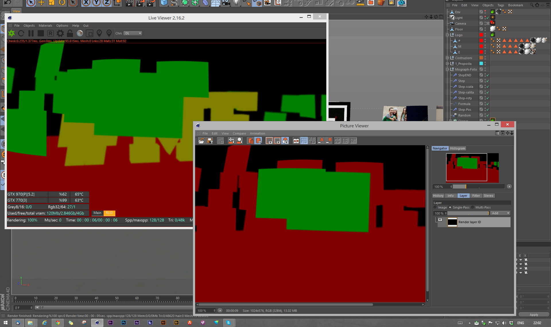

Hi, i've some trouble with layer mask when i render to picture viewer.
the result is incorrect.
have some1 else noticed that?
Seems he stop calculating after 31 passes
Thanks.

Version? Have you watched the passes tutorial?insertcoin wrote:Hi, i've some trouble with layer mask when i render to picture viewer.
Thanks.

i've seen that in 2.16.2 there is no voice under render setting for separate id layer mask.
So after watching tutorial found here : http://inlifethrill.com/trainings/octan ... ayer-mask/
i tried 2.22.2 test3 where menu render pass layer is present.
And yes, i've seen all possible tutorial.
I'm trying for two hours now.. but i can't see how to... and we are close to deadline..
thanks
thanks
