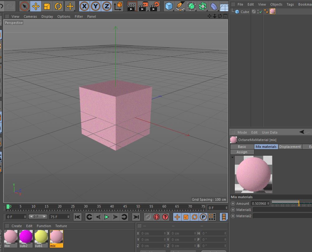

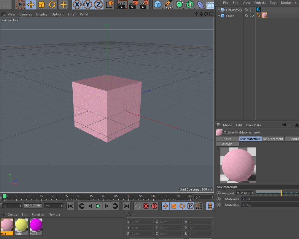

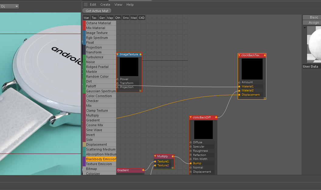

fuchsundvogel wrote:R17.032 / Win7
when i copy a object with mixmaterial into a new scene. i get a new mixmaterial with no submaterials applied on the object. the old and working mixmaterial is also in the new scene but not applied to the object.
Same topic, other issue i forgot to post here - When i copy an object with mixmaterial into a new scene the object and mixmaterial transferred fine but the mix amount slot arriving empty (Screenshots from source and target scene attached )

Can someone try this version for problem? I hope that i found a solution.fuchsundvogel wrote:R17.032 / Win7
https://render.otoy.com/customerdownloa ... .1-win.zip

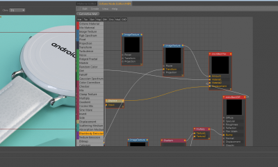

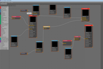

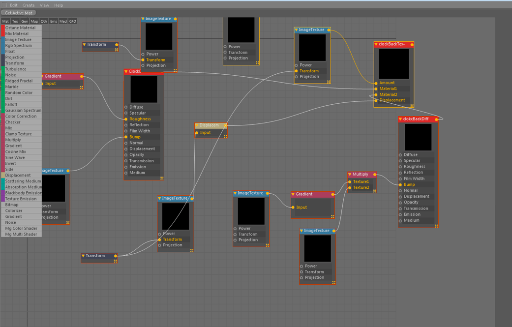

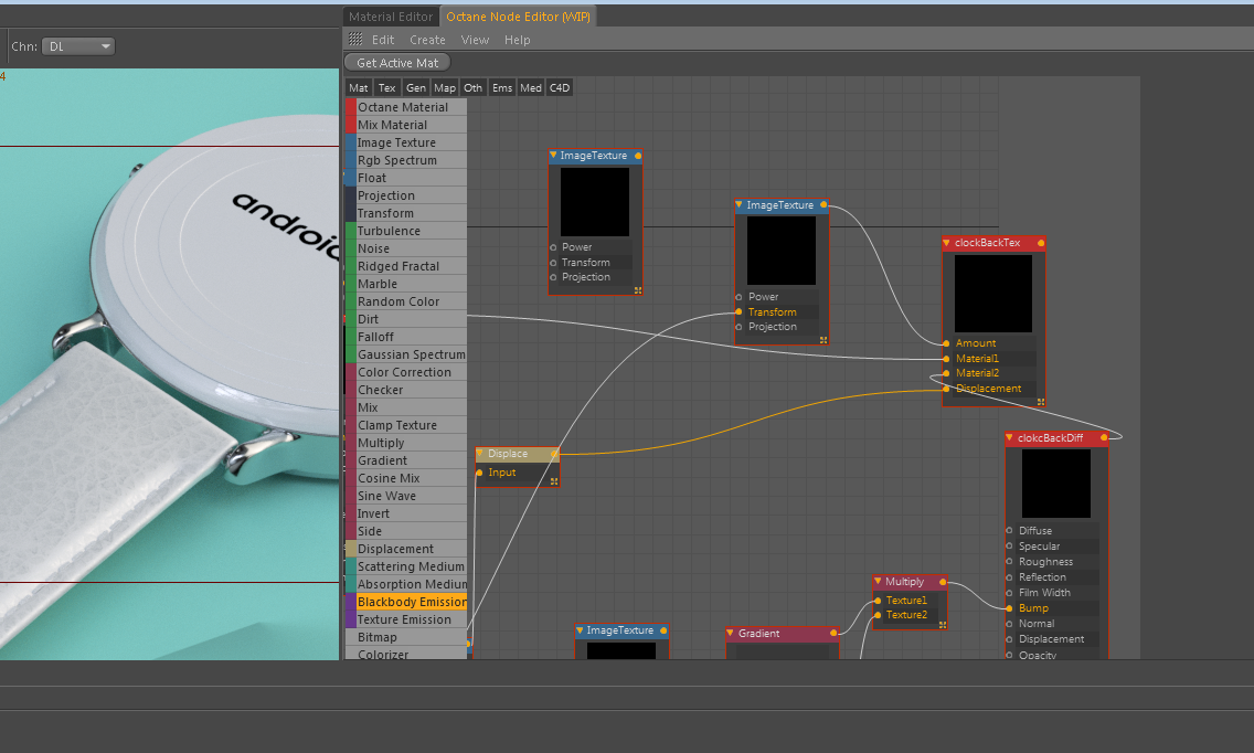

Not working for me on this version Ahmet (R17) - Now nodes of the mix material amount transferred to the other scene but they not connected. (screenshots attached)
BTW - View - frame all / frame selected not working in node editor. it zooming out to the maximum.
