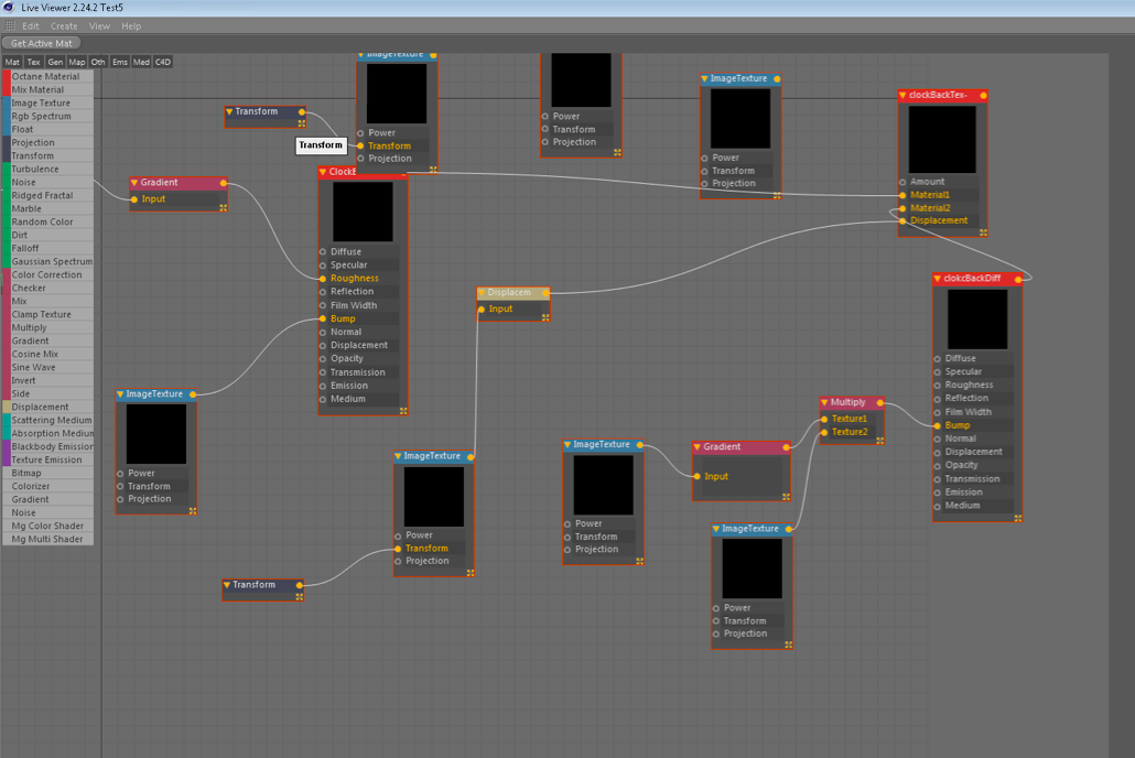

Same topic, other issue i forgot to post here - When i copy an object with mixmaterial into a new scene the object and mixmaterial transferred fine but the mix amount slot arriving empty (Screenshots from source and target scene attached )

Not working for me on this version Ahmet (R17) - Now nodes of the mix material amount transferred to the other scene but they not connected. (screenshots attached)
BTW - View - frame all / frame selected not working in node editor. it zooming out to the maximum.
