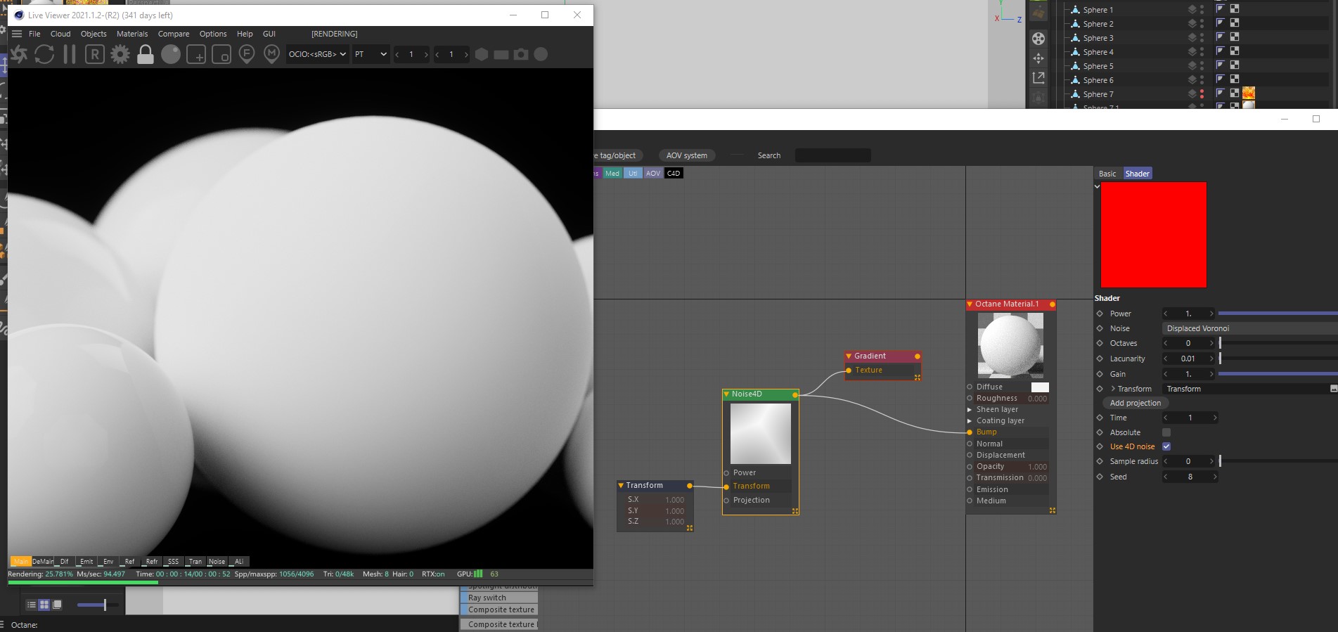

Until recently I noticed the "Noise4D", which is pretty awesome! I see there are some differences compared to the "Noise" node.

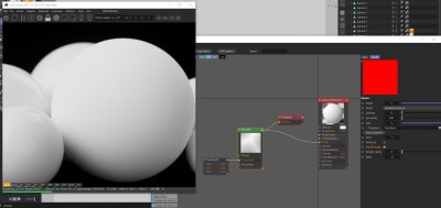

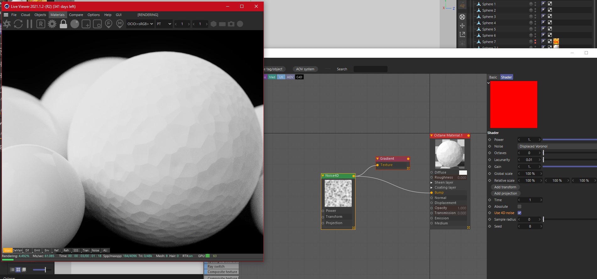

I have been playing with it lately. I noticed, "transform node" doesn't work with this particular node right?
Regards,
Noise4D with no Transform node works great
Noise4D with Transform node doesn't work

Try adding a projection node.
Puget Systems / Intel Core Z790 ATX / RTX 4090 / Cinema 4D
Kalua
Posts: 571
Location: Caribbean Sea
jayroth2020 wrote:Try adding a projection node.
Yes!
It did the job!
Thank you, jayroth2020.

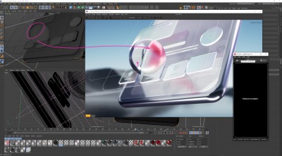

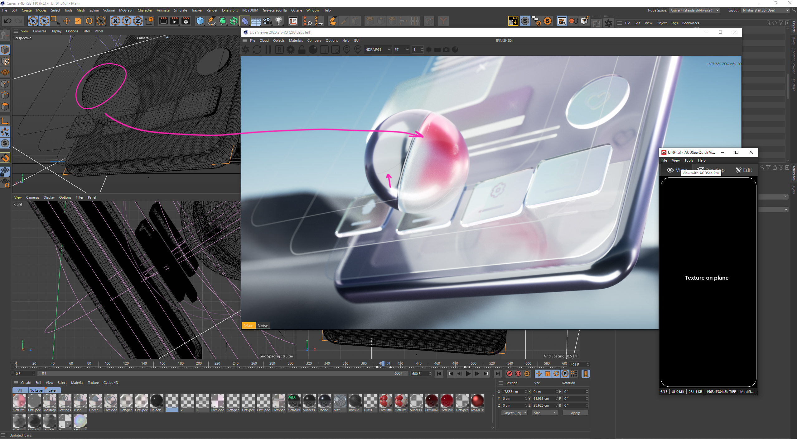

Hello, have you any idea to fix this issue?
I have a plane with opacity (texture) in material and it intersect ball. I get tiny frinde in intersection place.
I tried to change priorities in materials, tried to use rayswitch to fix it, changed grayscale texture to rgb. Unsuccessfully.

divasoft wrote:Hello, have you any idea to fix this issue?
Man you are using Octane 2020.2.5 R3 , this topic is for 2021 octane right?
You want to fix a physically correct thing , Your transparent plate has a reflection at the edges, which means that the same reflection will appear in the intersection edges
Doesn't that make sense to you?
Separate edges, problem solved.
divasoft
Posts: 349
Joined: Thu Jul 01, 2010 3:59 am
Location: Russia
There should not be any reflections at the intersection of the plane and the ball, because this area of the plane is completely transparent.
Have you tried:
- Play with Ray epsilon values
- Play with Diffuse, Specular and Scatter depth values;
- Nested dielectrics ticked off
- Alpha shadows
- Fake shadows

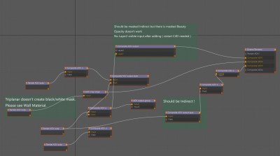

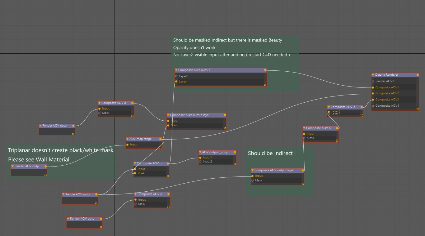

Please see how is wrong with AOV system. There are some issues.
Generally I want to add/mix Diffuse Indirect ( masked by Triplanar Y- from Wall Material ) with Beauty. Masked Indirect by Triplanar works fine but mixing this with Beauty no. Also Triplanar AOV should give black/white mask. There is need to use Range AOV but after that there is visible outline on mask border.

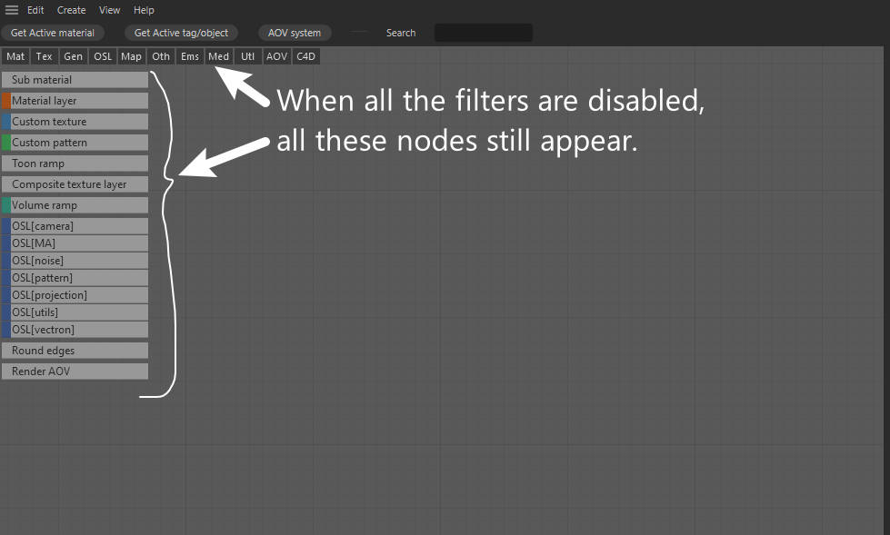

This UI bug in the node editor has been around for a long time.
Many of the nodes are still not associated with a filter.
