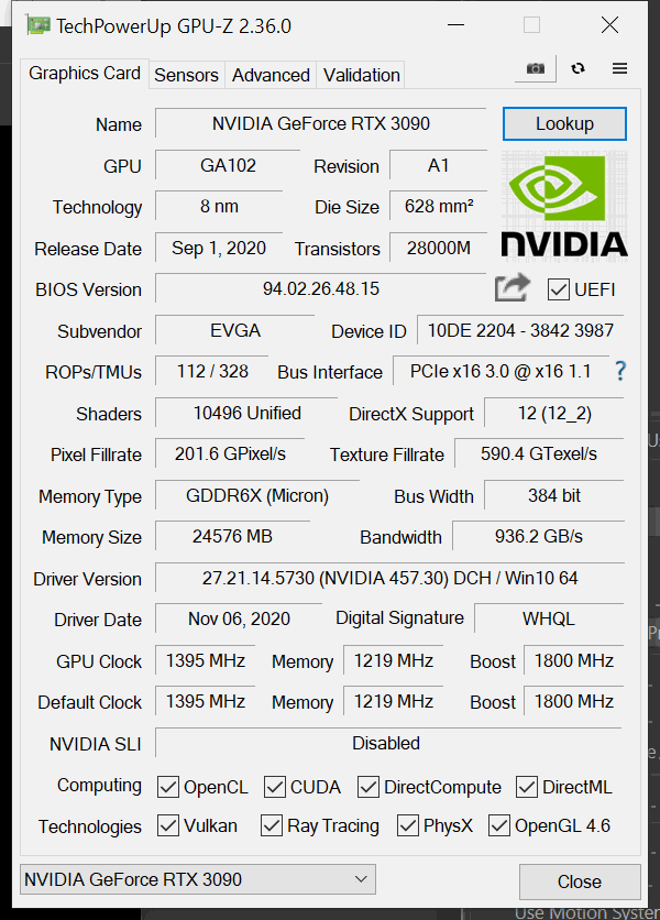

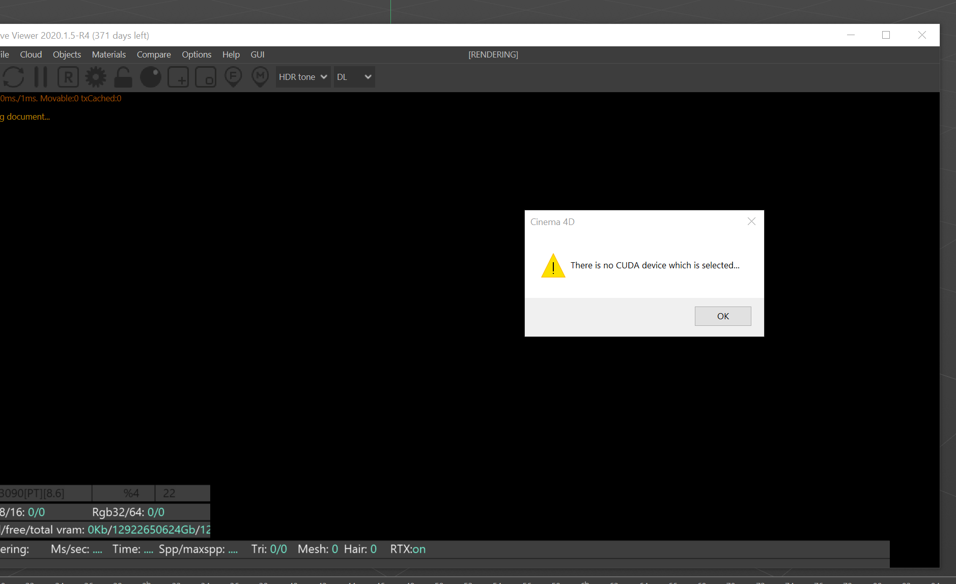

I'm having the same issue - just purchased Octane 2020 Enterprise and built a new rig. Im trying to install Octane 2020.1.5-R4 Have the EVGA RTX 3090 FTW3 Ultra
I'm on windows
I'm on windows
Fixed it - installed the latest CUDA package and it worked - also went into octane settings and selected the GPU. Thx
to work with the latest versions of Octane, you need to firstly update the Nvidia driver to version 456.38 or greater, with a clean installation.
Then install also Standalone, to be able to install the latest cuDNN library:
viewtopic.php?f=33&t=76603
During the first start, you will be asked to press the download button, to automatically install the necessary cuDNN library:
If not enough, please go to Octane Settings/Devices panel, and check that the Nvidia GPUs are enabled.

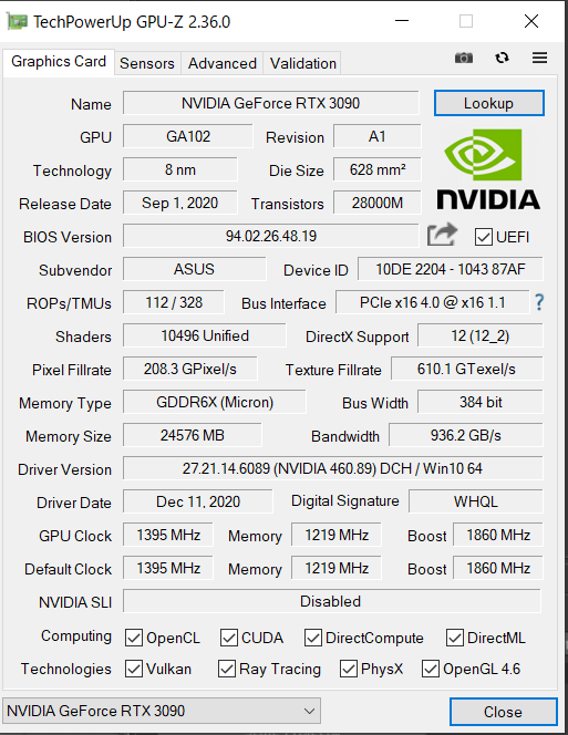

Started logging on 12.04.21 18:19:01
OctaneRender Demo 2020.1 (8010000)
device 0: failed to find a CUDA binary matching compute model 8.6
I can't make it work in max 2021 have latest studio drivers rtx 3090 , standalone works fine - it is a demo for both on win10 enterprise

Hi Keks,keks wrote:Started logging on 12.04.21 18:19:01
Octane for 3dsMax plugin v2020.2.3 demo version (working with RTX 3090) will be updated as soon as possible.
