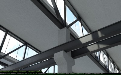

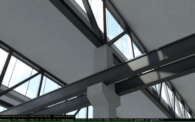

I have made some comparison test between 3.08 and this new release but it seem much much slower
Same scene :
V 3.08 time 00:53
V4 RC2 time 02:56
Rendered both with pathtrace and without denoiser...
How it's possible?
MAC 10.12.6 + GTX 1080Ti - Driver NVIDIA 387.178
SLAVE Win 10 + 3x GTX 1080Ti + 2x GTX 980Ti - Driver NVIDIA 398.82
C4D R19.068
Same scene :
V 3.08 time 00:53
V4 RC2 time 02:56
How it's possible?
C4D R19.068

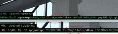

hi aoktar
Why in some versions (the bottom of the live viewer) the number of polygons (Tri) is doubled?
For example version 3.8.3 or the same version 4
Or the same screenshot in Previous comment
and it takes more VRAM size
Thank you
Thank you

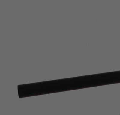

Just to show a quick example of what is happening, this is supposed to travel along the length of the cylinder but it's stopping not far from where it starts (it's a gif so you will have to click on it):
If I look at this in the IPR but I stop the IPR and restart it again, the projection ends up where I expect it to be.
Thanks.
Thanks.

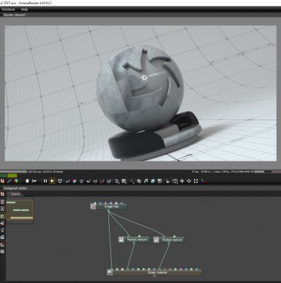

What about the image tiles node in v4 StandAlone?
Any chances having it by V4 Stabled?

I don't see this kinda problem between versions. Could you please try again with different scenes and provide a sample scene if you could reproduce it?rezaansari wrote:hi aoktar
Thank you
