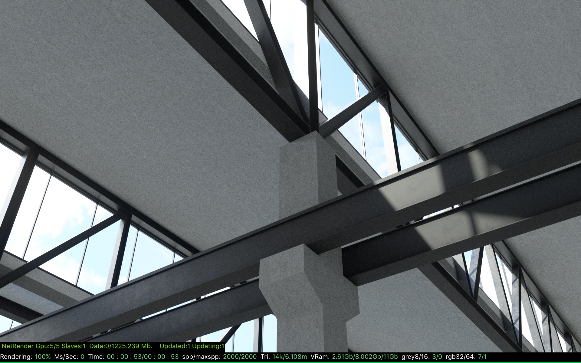

I have made some comparison test between 3.08 and this new release but it seem much much slower
Same scene :
V 3.08 time 00:53
V4 RC2 time 02:56
Rendered both with pathtrace and without denoiser...
How it's possible?
MAC 10.12.6 + GTX 1080Ti - Driver NVIDIA 387.178
SLAVE Win 10 + 3x GTX 1080Ti + 2x GTX 980Ti - Driver NVIDIA 398.82
C4D R19.068

Why in some versions (the bottom of the live viewer) the number of polygons (Tri) is doubled?
For example version 3.8.3 or the same version 4
Or the same screenshot in Previous comment
and it takes more VRAM size
Thank you

I don't see this kinda problem between versions. Could you please try again with different scenes and provide a sample scene if you could reproduce it?rezaansari wrote:hi aoktar

I'm testing on Standalones and I can see similar difference between V3 and V4. I cannot know because rendering that's done by the renderer. I'll ask to core dev. teamstefano-dear wrote:Hi,
I have made some comparison test between 3.08 and this new release but it seem much much slower![]()
Same scene :
V 3.08 time 00:53
V4 RC2 time 02:56
How it's possible?
