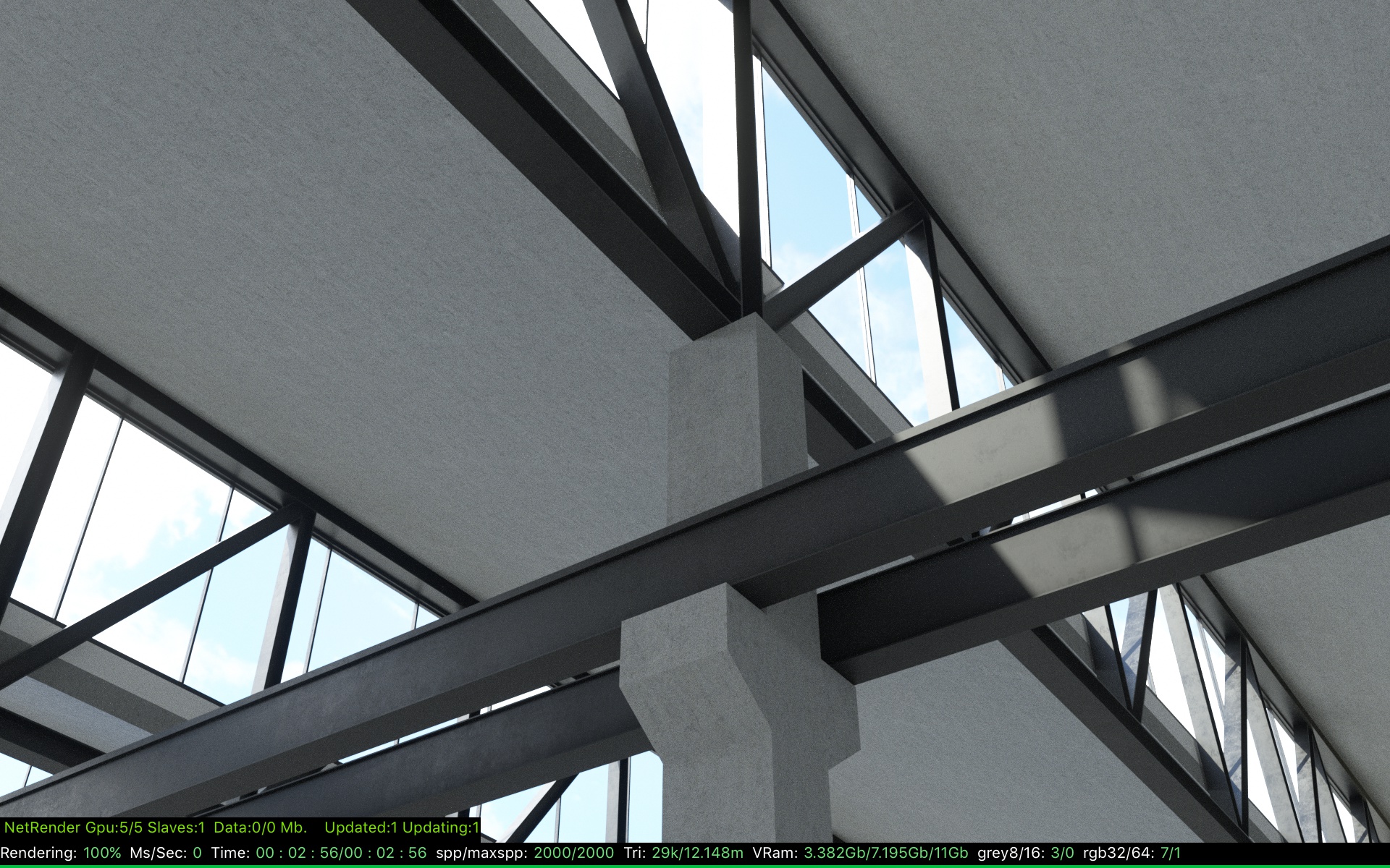

I have made some comparison test between 3.08 and this new release but it seem much much slower :o
Same scene :
V 3.08 time 00:53
V4 RC2 time 02:56
Rendered both with pathtrace and without denoiser...
How it's possible?
MAC 10.12.6 + GTX 1080Ti - Driver NVIDIA 387.178
SLAVE Win 10 + 3x GTX 1080Ti + 2x GTX 980Ti - Driver NVIDIA 398.82
C4D R19.068

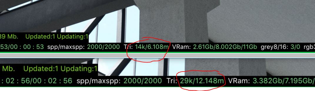

rezaansari
Posts: 22
Joined: Sun Nov 22, 2015 8:47 am
Location: tehran-iran
hi aoktar
Why in some versions (the bottom of the live viewer) the number of polygons (Tri) is doubled?
For example version 3.8.3 or the same version 4
Or the same screenshot in Previous comment
and it takes more VRAM size
Thank you

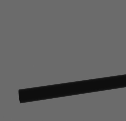

noisyboyuk
Posts: 103
Joined: Thu Apr 21, 2016 5:28 am
Just to show a quick example of what is happening, this is supposed to travel along the length of the cylinder but it's stopping not far from where it starts (it's a gif so you will have to click on it):
If I look at this in the IPR but I stop the IPR and restart it again, the projection ends up where I expect it to be.

rezaansari wrote:hi aoktar
Thank you
I don't see this kinda problem between versions. Could you please try again with different scenes and provide a sample scene if you could reproduce it?

stefano-dear wrote:Hi,
Same scene :
V 3.08 time 00:53
V4 RC2 time 02:56
How it's possible?
I'm testing on Standalones and I can see similar difference between V3 and V4. I cannot know because rendering that's done by the renderer. I'll ask to core dev. team
