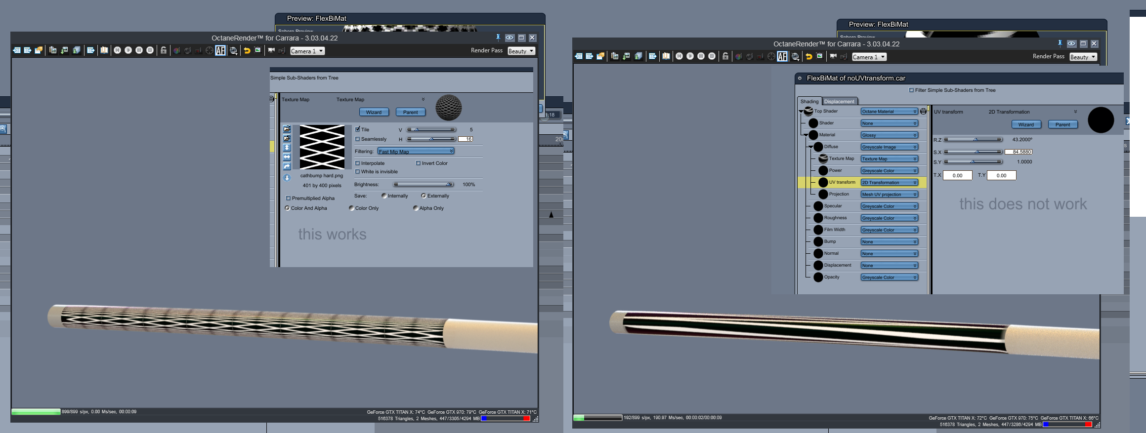

Hi Simon,
2 problems:
I have a material which is not allowing any Octane UV transform. Oddly, it does allow Carrara UV transform.
The same crosshatch bitmap does work in other Octane Materials. I will work around, but would like to know how to correct the existing Material instead of swapping it out.

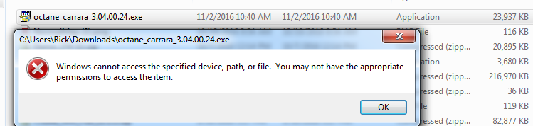

Separately, I am not able to update to the latest, per attached.
thanks for your help,
Rick
noUVtransform.zip
(31.09 KiB) Downloaded 412 times
Sighman
Posts: 1112
Joined: Thu Jan 19, 2012 9:11 am
Location: Calgary, AB
Make sure Carrara is not running when you install.
Win8/64, I7-4770K (3.5Ghz) 24GB, GTX-980ti (6GB) / GTX-TITAN (6GB)
protovu
Posts: 476
Joined: Thu Sep 11, 2014 7:30 pm
Sighman wrote:Make sure Carrara is not running when you install.
Yep..sure enough was the problem.
Was able to install, but not able to use. Kept crashing on polygon selection in vertex model room.
