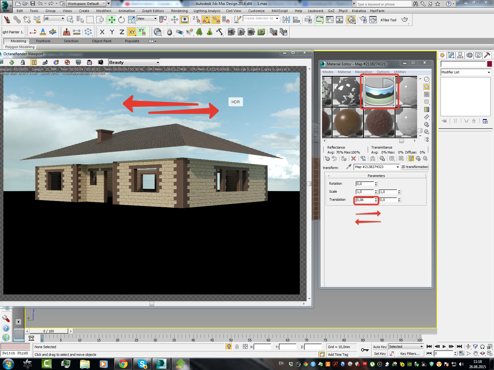

HDR BUG
if you change the placement of the texture environment through 6-7 clicks environment ceases to change
we must re restart the viewport

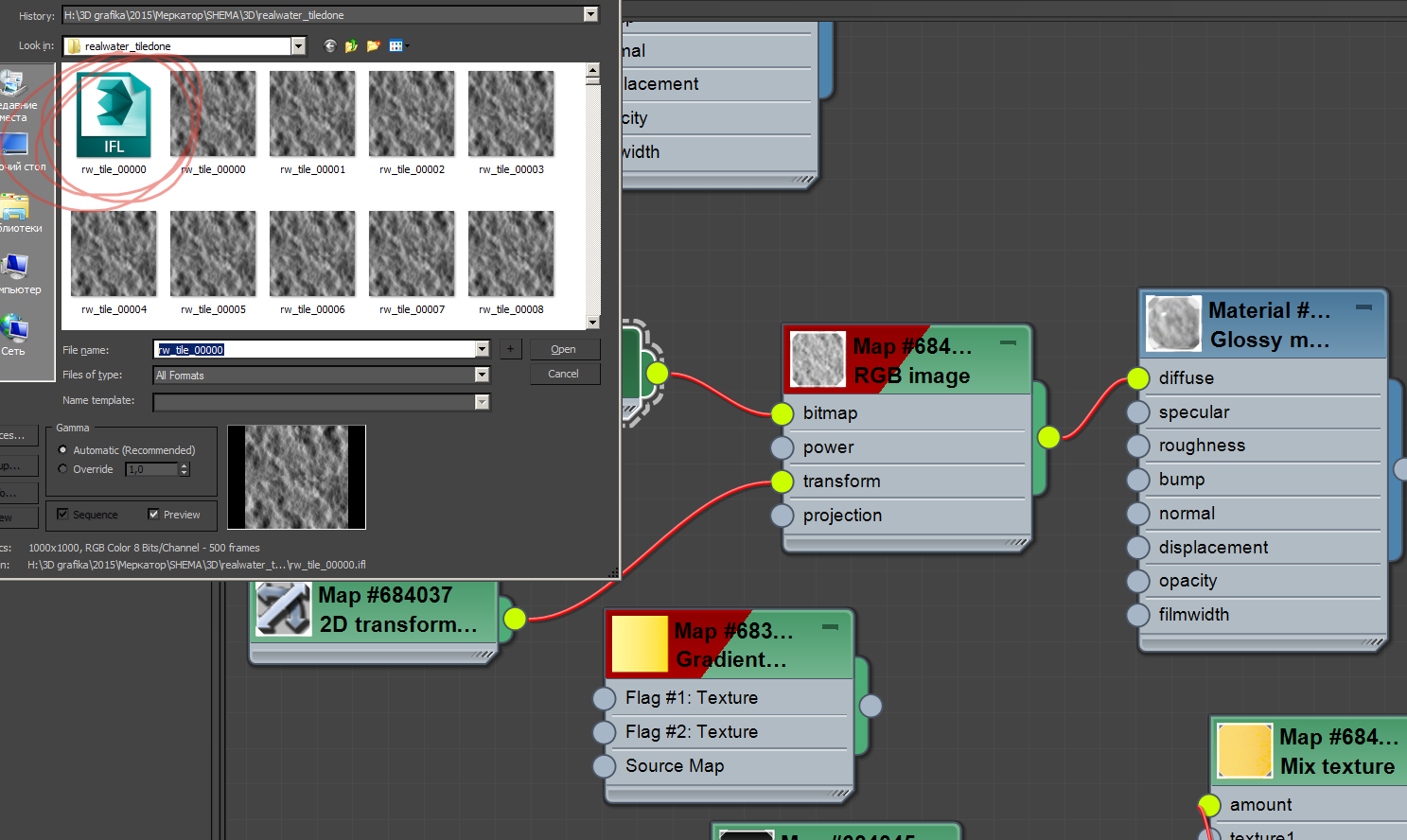

don't support the sequence of images
Oh God when that day comes when octane in functionality to perform all the available functions 3dmax
when will I stop spitting from minor mischief in this perfect render :?

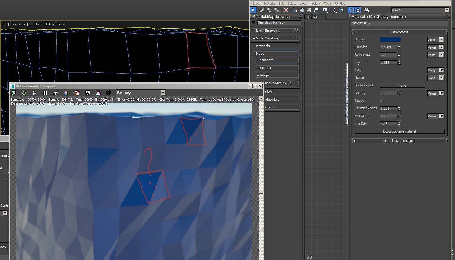

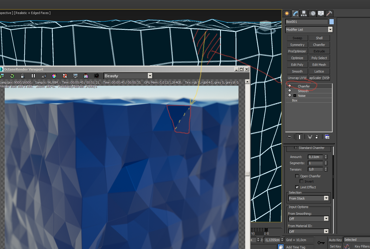

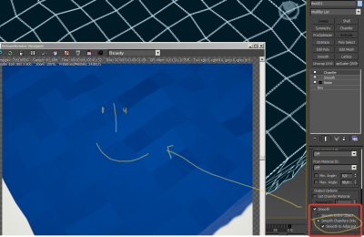

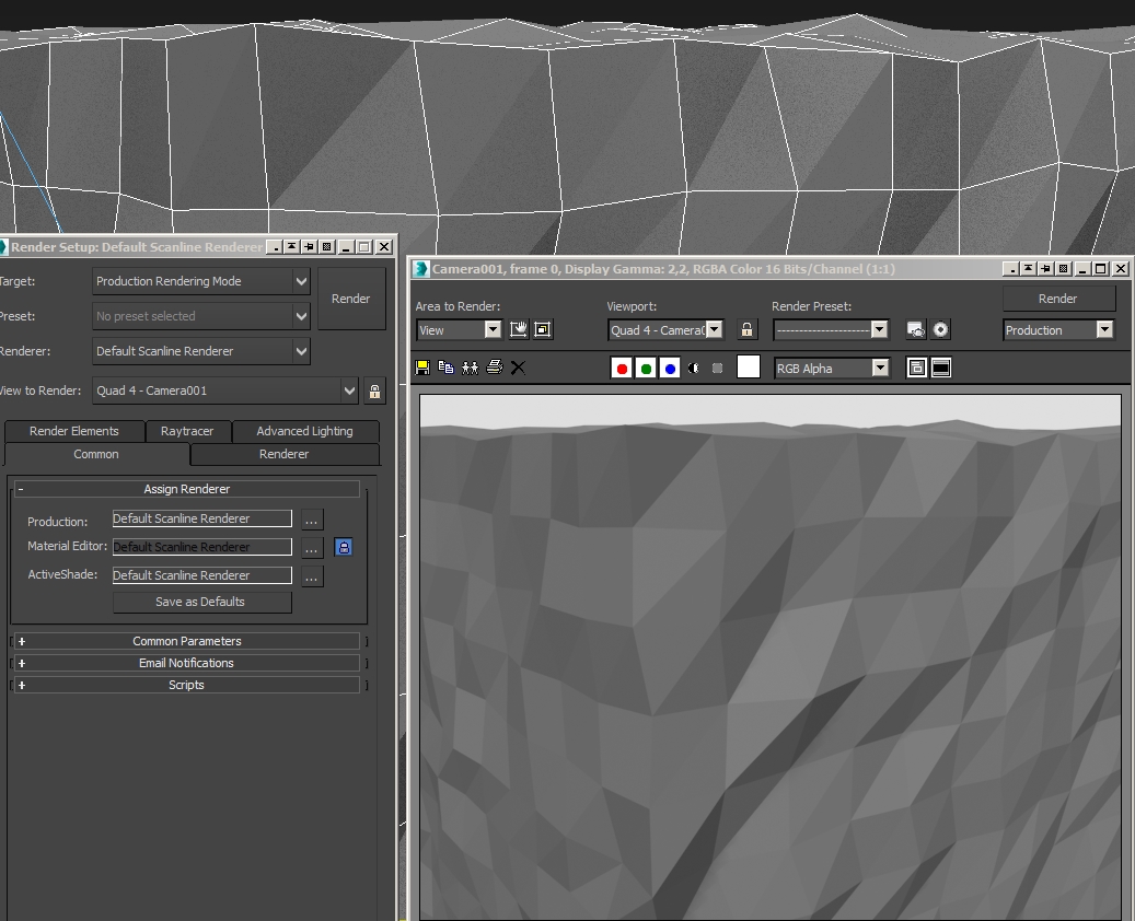

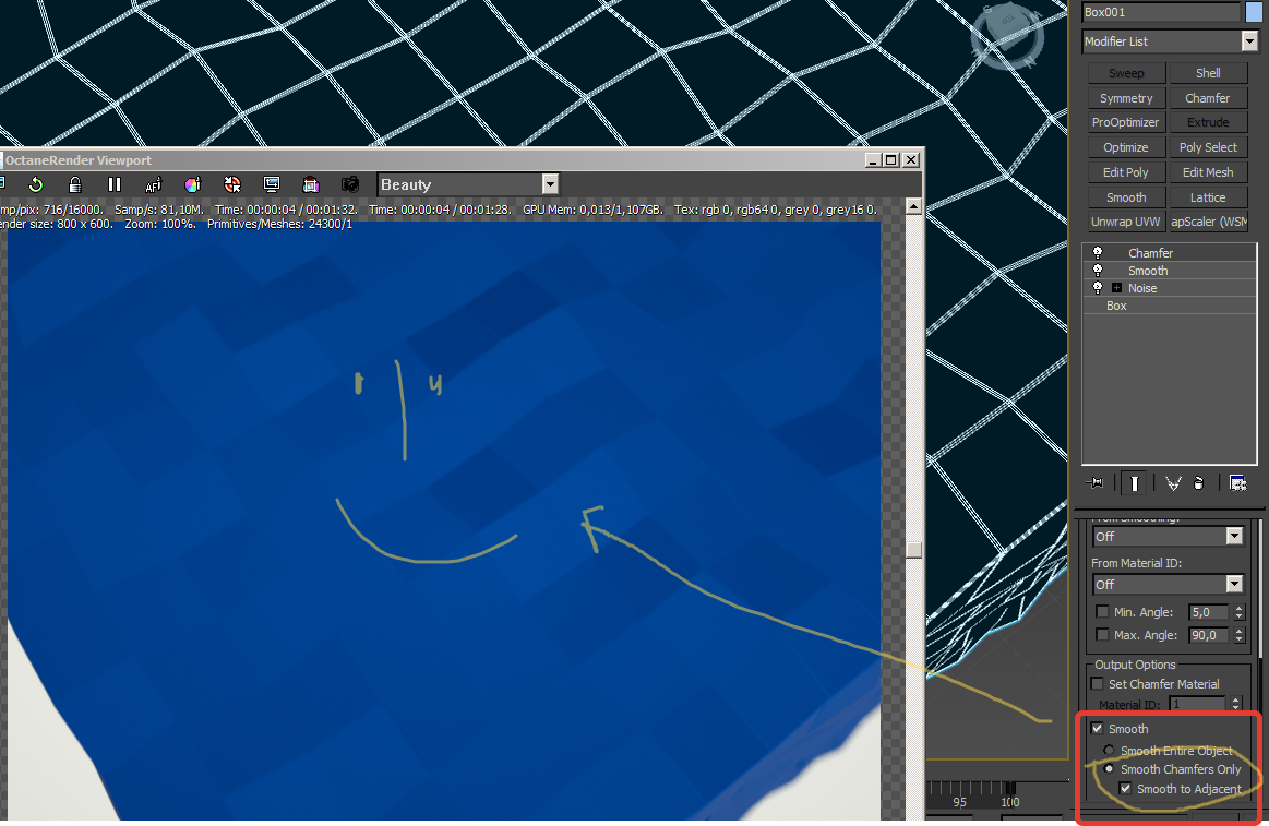

where did the triangles please tell me ?
I found a way to deal with error (Smooth Chamfers only + to Smooth Adjustment)

Goldisart, what are you mean? what kind of nonsense? octane has nothing to do with it.
on the top view of lighting is flat, so triangles are not visible.

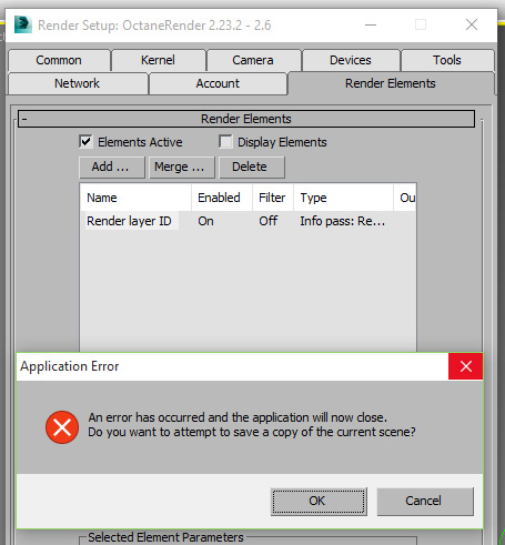

Max 2014 crash when trying add some render pass to RenderElements window.
GPU: 2x4090; 3ds max;

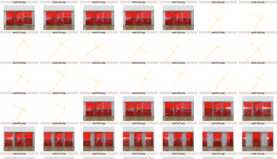

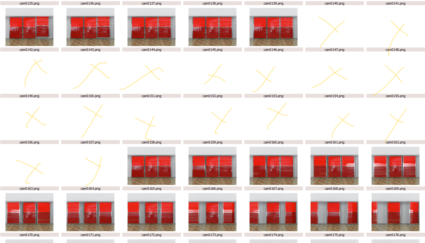

1. does not work correctly render elements - black frames . 2. Does not work correctly sequence the render (black frames) - skips between frames empty frames render
the standalone version (OK!) - it works during the conversion output is only to convert the animation in the standalone version
