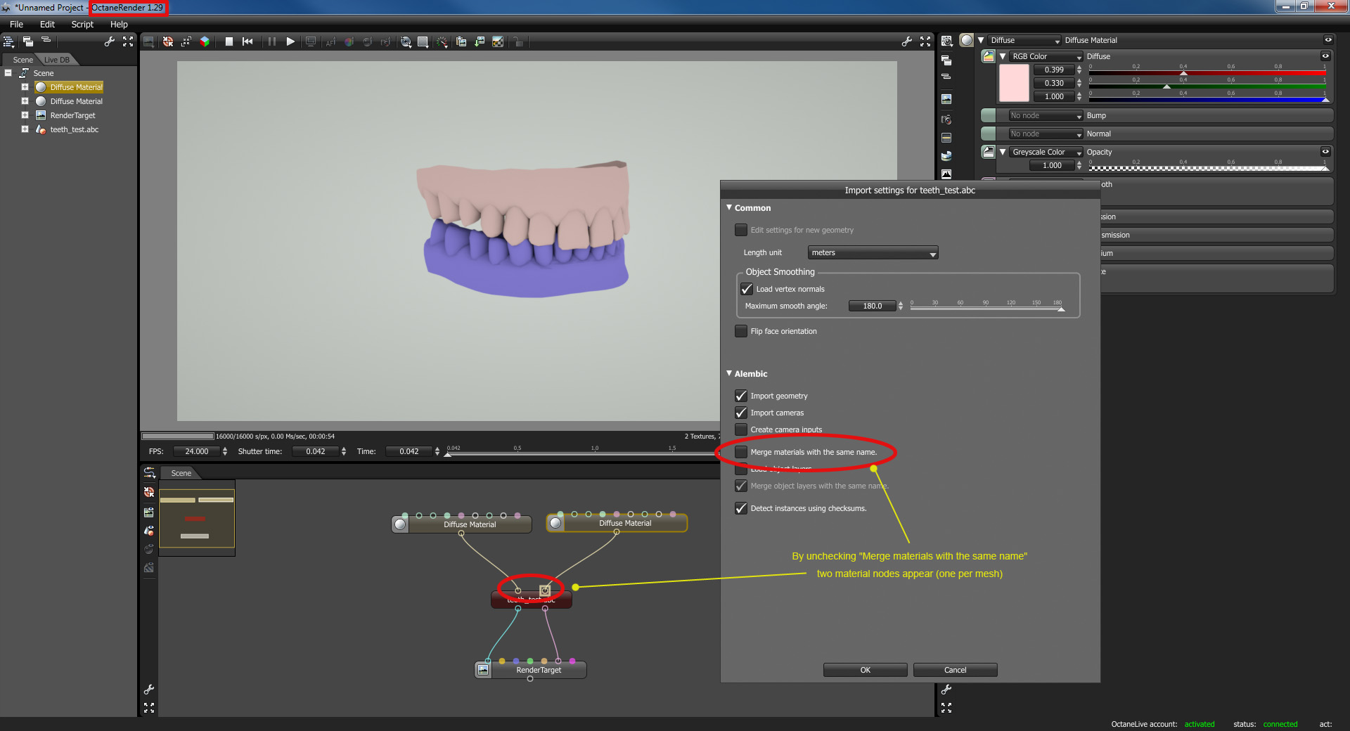

Rikk The Gaijin wrote:This is what I export from Maya
And this is what comes in Octane (after I manually set the Alembic scale to centimeters)
Hi Rikk
With regards to the alembic node and assigning materials, it works differently than it does on a .obj. So far I have not been able to get shader inputs per shader in my maya scene to work at all (like it does with obj's... But what you can do is un-checkbox the "hide materials with same name". This will give you an input per shape object in the alembic in stead. This can be quite messy sometimes if you have a lot of objects that would use the same shader, but you can at least assign shaders to anything you want.

gardeler wrote:Hi Rikk
A heads up is that Maya2014 has export UV's off as default in the alembic exporter. But last time I tested maya's exporter with UV's on, it crashes octane when I tried to load the alembics. But that was a while back. I have not tested it with 1.31.
hope this helps.
Thank you gardeler, unchecking the "Merge materials with the same name" option helped a bit, but like you said, I will have duplicated materials, but that's better than nothing, for now.

Btw, in version 1.31 I DON'T HAVE ANY NODE for the materials in the alembic file.
If I uncheck "Merge materials with the same name" in the alembic option, just one node pops up, instead of a per-mesh node like in the previous version.
Roeland, why is this happening?

Rikk The Gaijin wrote:Btw, in version 1.31 I DON'T HAVE ANY NODE for the materials in the alembic file.
That's a bug in the Alembic loader, we have fixed in the next release.
Roeland
