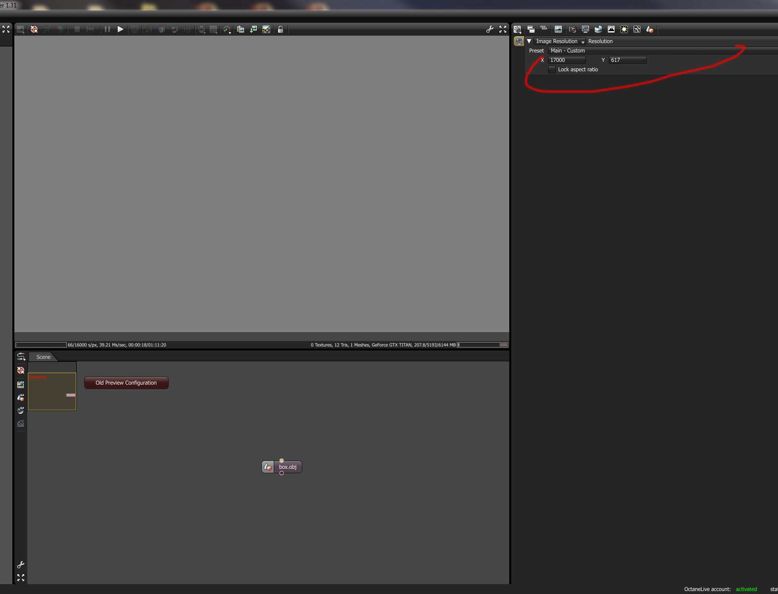

I tried to increase a very simple scene resolution. What I managed to achieve was something about 16000 x 600 (Titan). Then a blank gray screen appears and I cannot display a model in the preview window anymore and I must close Octane. See the screenshot. Is this OpenGL limitation or should it work under such resolutions?

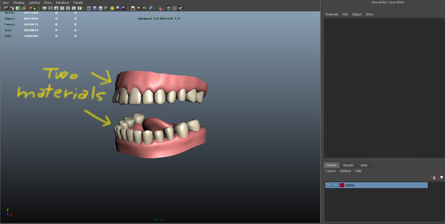

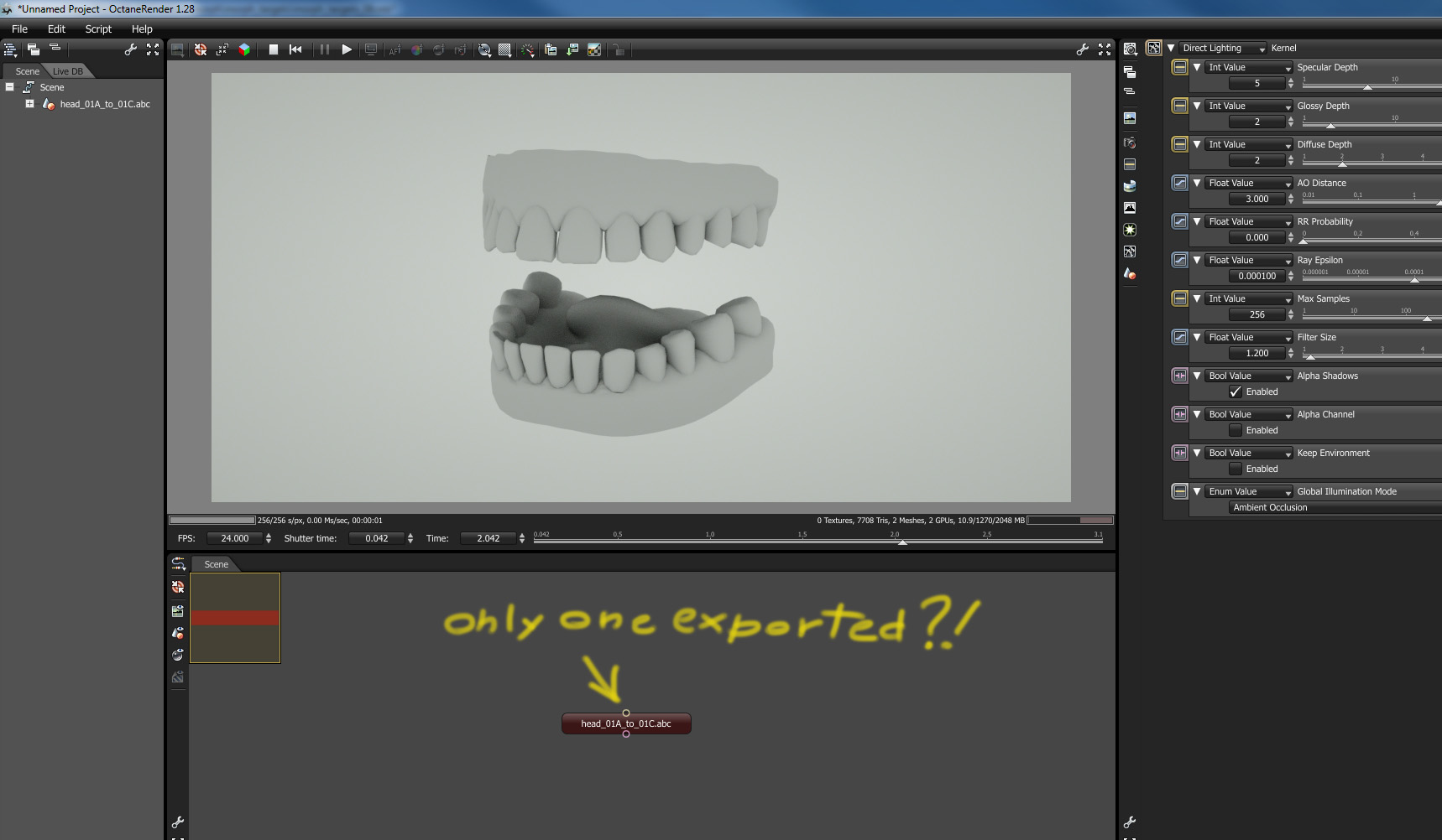

I also have another problem (it seems Alembic support is completely screwed) :?
That's the OpenGL limitation I mentioned. You can get around it using the software viewport (File -> Preferences -> Application -> Viewport).

Rikk The Gaijin wrote:I also have another problem (it seems Alembic support is completely screwed) :?
Could you post an example file and a screenshot how it appeared in previous versions and in 1.31? Thanks.
