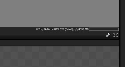

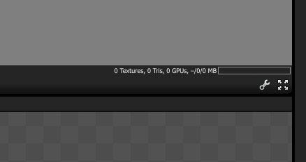

I bought a 4gb gtx670, on 2.58e failed, and the 2.59 does not see any GPU.
installed every driver from 301.42 to 306.23 all failed (installed only graphic driver and removing every time with sweeper)
WIN7/x64/i7/16RAM/EVGAGTX670 4GB/
hmmm...?

draftart wrote:I bought a 4gb gtx670, on 2.58e failed, and the 2.59 does not see any GPU.
hmmm...?
You need install and use either the latest release candidate beta 3.03 (http://render.otoy.com/forum/viewtopic.php?f=33&t=24074) or for the older Octane versions, one of the Kepler builds (like http://render.otoy.com/forum/viewtopic.php?f=33&t=20911), because your GPU is of compute model 3.0 which isn't supported by older Octane versions by default.
I recommend to use the beta 3.03.
Cheers,
Marcus
hmmm...?
Cheers,
Marcus
many thanks Marcus!
