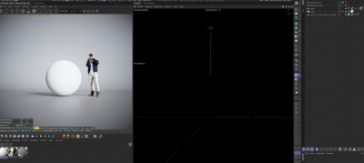

aoktar wrote:

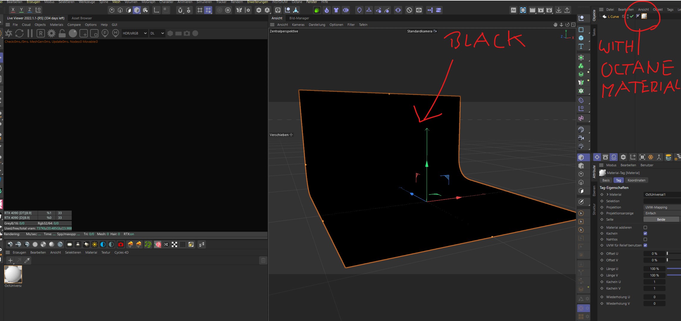

miohn wrote: every object in the viewport whis has an octane material appears black.
So I have a stage-object and 2 other objects on the stage (f.e. my startscene "new.c4d") and all is black
The attachment Startscene.jpg is no longer available
Your viewport is fully filled by objects, so viewport is not black. Covered objects are with black textures. Spend some time to play with content to gather more info.

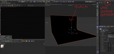

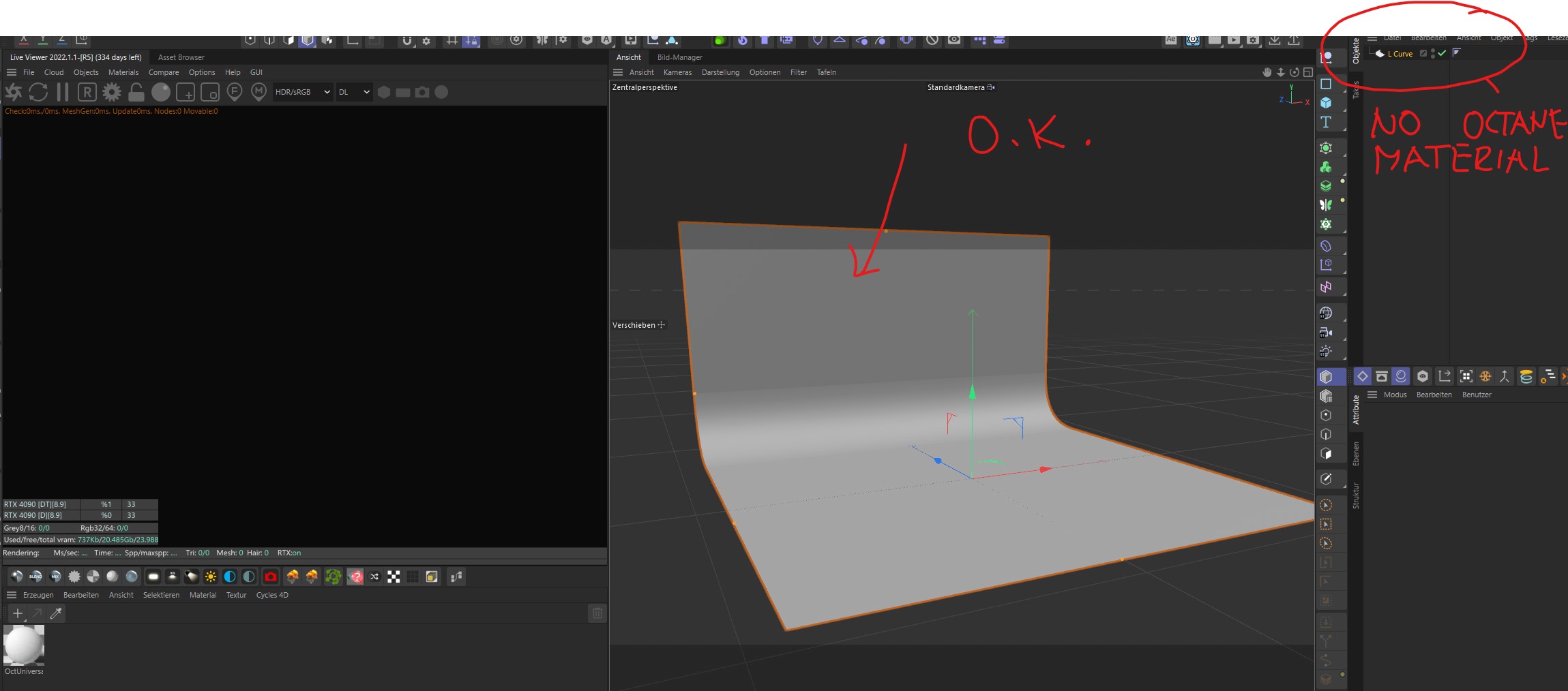

come on!
As I said two times: objects with octane material applied are displayed black in the viewport
Hope these screenshots are understandable now. ;)
All was fine before I updated to 2023.2.2.
Now I'm back to 2023.2.1 but this problem is still present!
I cannot work proberly when I cannot see anything in the viewport, because all objects are displayed black.
Is'nd there a workaround for that?
thanks
Mike

miohn wrote:
z
come on!
Delete oct.dat while C4D not open, it's in prefs folder. And START C4D
thanks
Mike
miohn
Posts: 783
Joined: Sun Jun 06, 2010 3:00 pm
just that simple!
Deleting the "oct.dat" solved it!
Thanks very much!
Mike

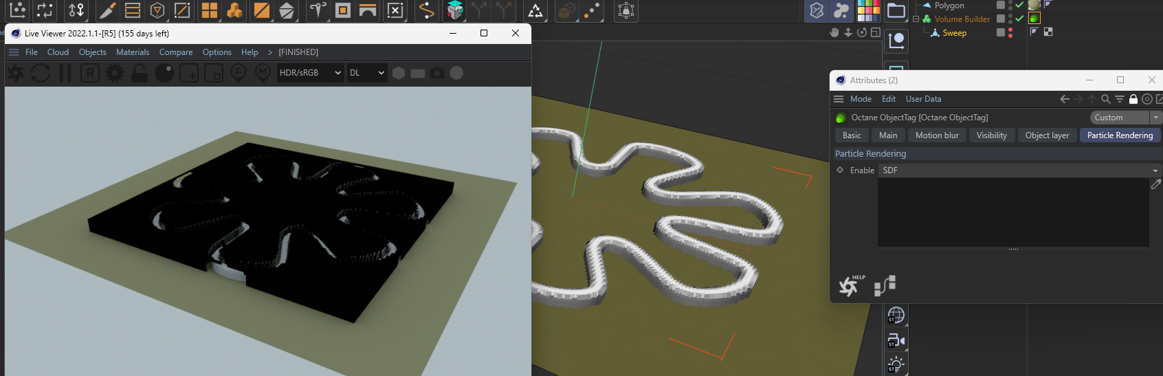

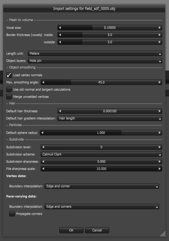

Another issue using SDF created from Volume Builder :
field_sdf_0002.zip
(414.68 KiB) Downloaded 122 times

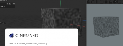

feedback: material tag exchange, not update
thanks
C4D 2023.2.1
Octane 2022.1.1-R5
material tag exchange, not update.mp4
(2.85 MiB) Downloaded 1848 times
