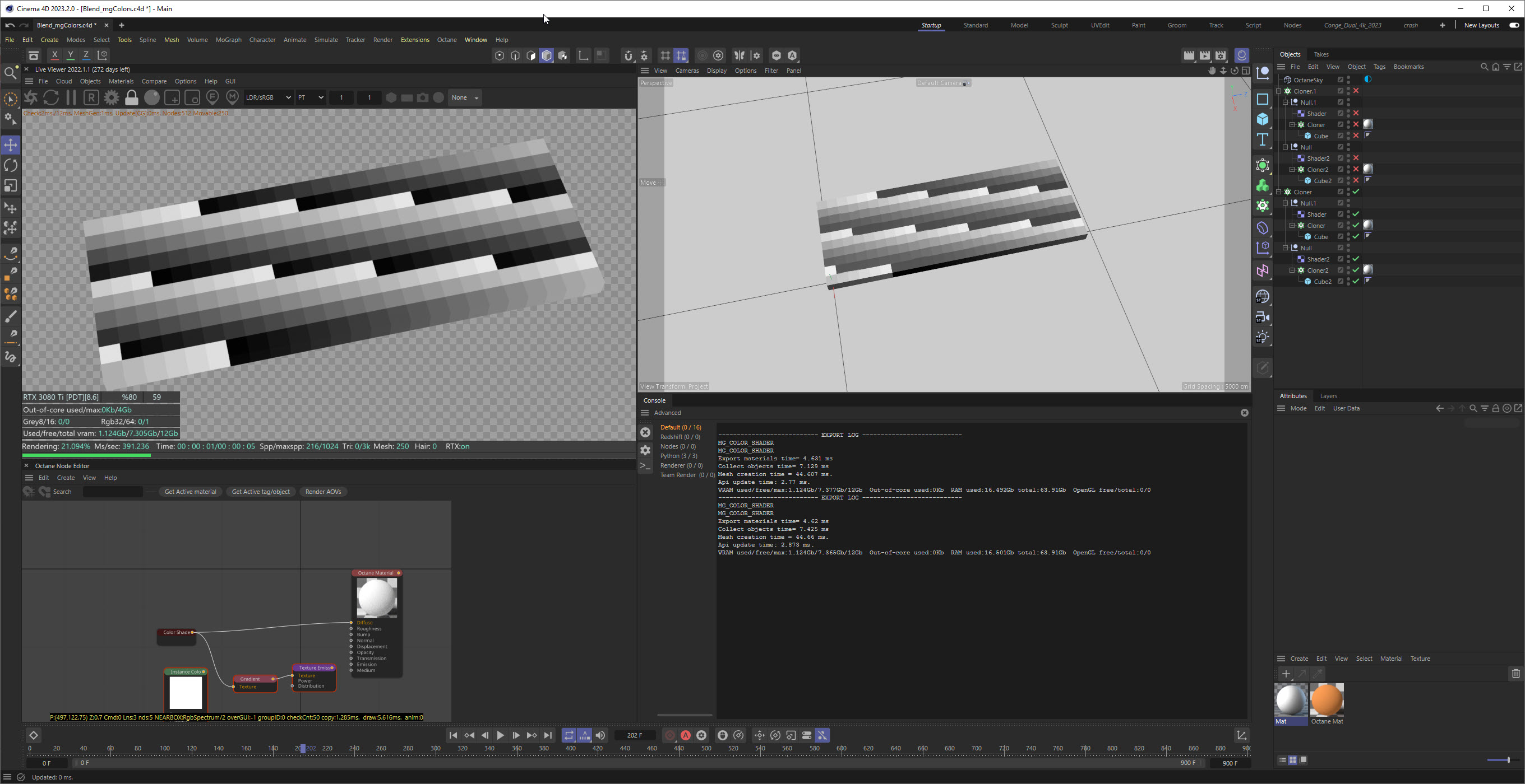

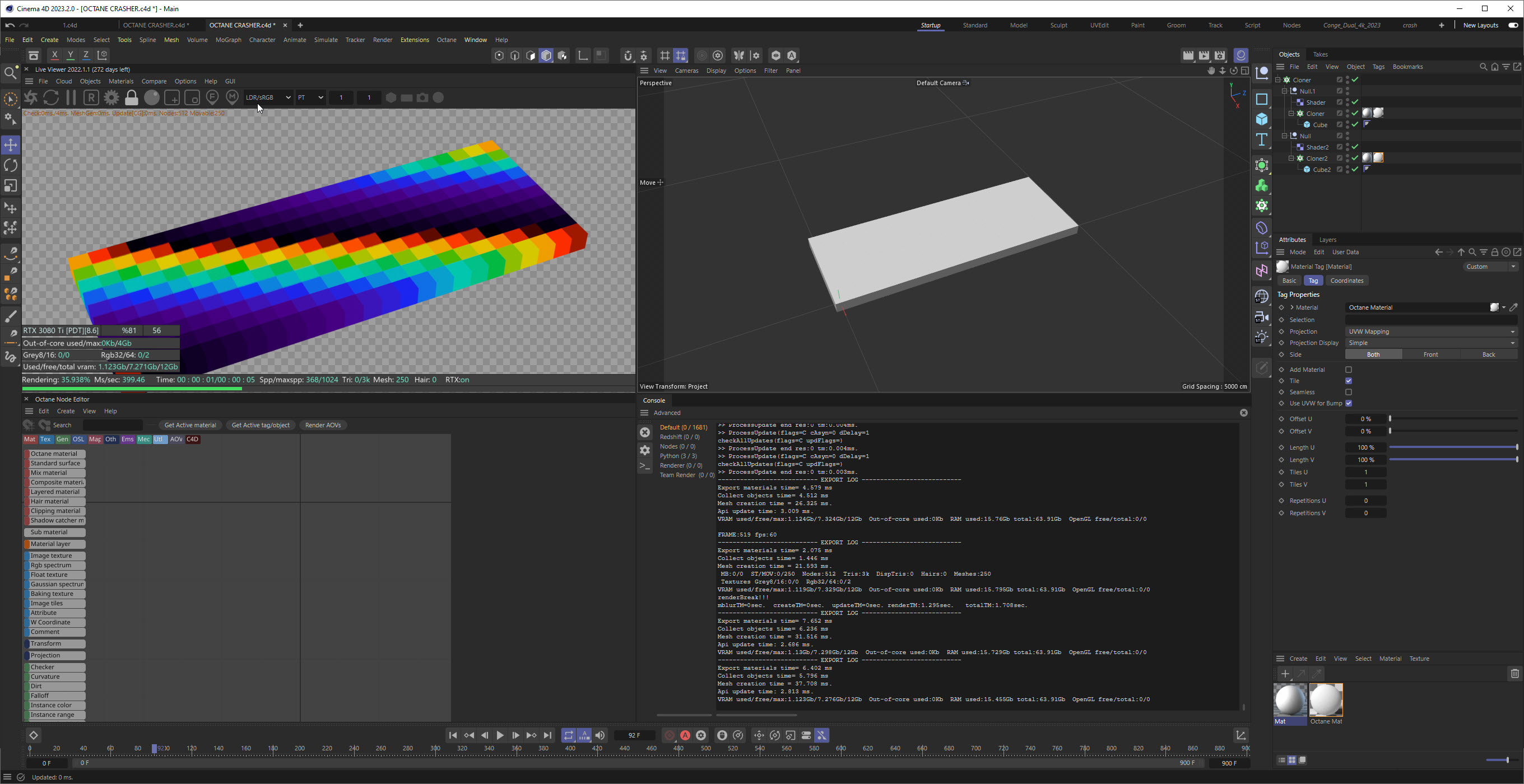

I was hoping with the instance color stuff worked in this might fix a serious bug that crashes Cinema 4D consistently:
For 6 years, over several versions of octane (4.0 to 2022.1.1), Cinema 4D (r17 to 2023) , different windows installations and different computers, this bug has always stuck around and it drives me absolutely crazy.
When I use a blend cloner that clones cloners with their own shaders, when I use an octane material to color the child objects using a gradient to map them, it hangs or crashes Cinema 4D spectacularly. It is impossible to generate a log because Cinema 4D either quits too fast or just hangs forever.
I made a simple example project that replicates this behavior, anyone can download it here if they'd like to try it:
https://drive.google.com/file/d/12Q8zme ... sp=sharing
It will either crash while you're clicking around on the timeline, or selecting a different gradient in the octane material node, or when rendering to picture viewer or in the render queue (it never renders more than 1 frame before crashing)
Please fix this I would be so grateful, there are so many things I want to use blended cloners for but this has been stopping me ever since I started using Octane
(I imagine finding the cause of this bug will also fix other crashes when I use cloners and shaders for materials)

It's working here. I'll test it more! BUT I'd love that to see more a calmer feedback. I don't see any post of you about it earlier for example. We cannot know the issues without user reports.

To add a data point, I was not able to crash the scene by manipulating anything in the UI, and the live viewer worked fine, however I did find that it would freeze after batch rendering a single frame, regardless of how I messed with the render settings our output. Here is the log.
I noticed that sometimes a File Explorer window would also freeze at the same time (but not all File Explorer windows), so it may be a higher order crash involving the video driver or some kind of VRAM corruption.
This is on Windows 11, C4d 2023.1.3, Octane 2022.1.1_R2, NVIDIA RTX4090, Studio Driver 31.0.15.2802
