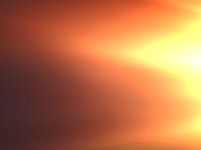

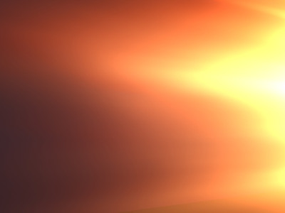

Hi Paride,
Why does VDB look so good but Phoenix FD simualted fire looks so bad and pixelated. This sample VDB you told me about looks great. How can we have the same for Phoenix FD fire? Same is with embergen it looks way better than phoenix fd.
I just checked up close and see zero pixels almost like it's a procedural flame. We need the same for Phoenix FD

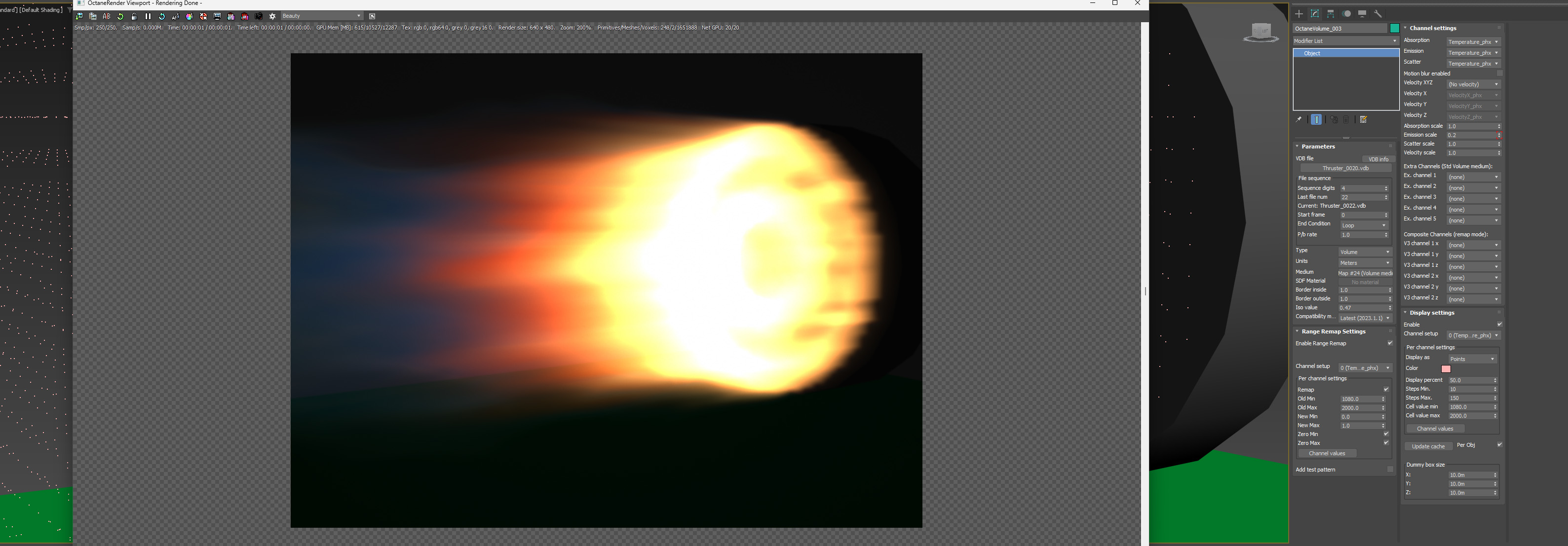

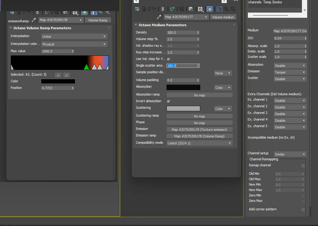

here is another example why does phoenix fd smoke looks flat and black no matter what I change? In older octanes smoke used to look like smoke with layers and different thicknesses.
The scene is attached
You will see embergen renders nicely and phoenix black flat smoke. Same volume texture for both

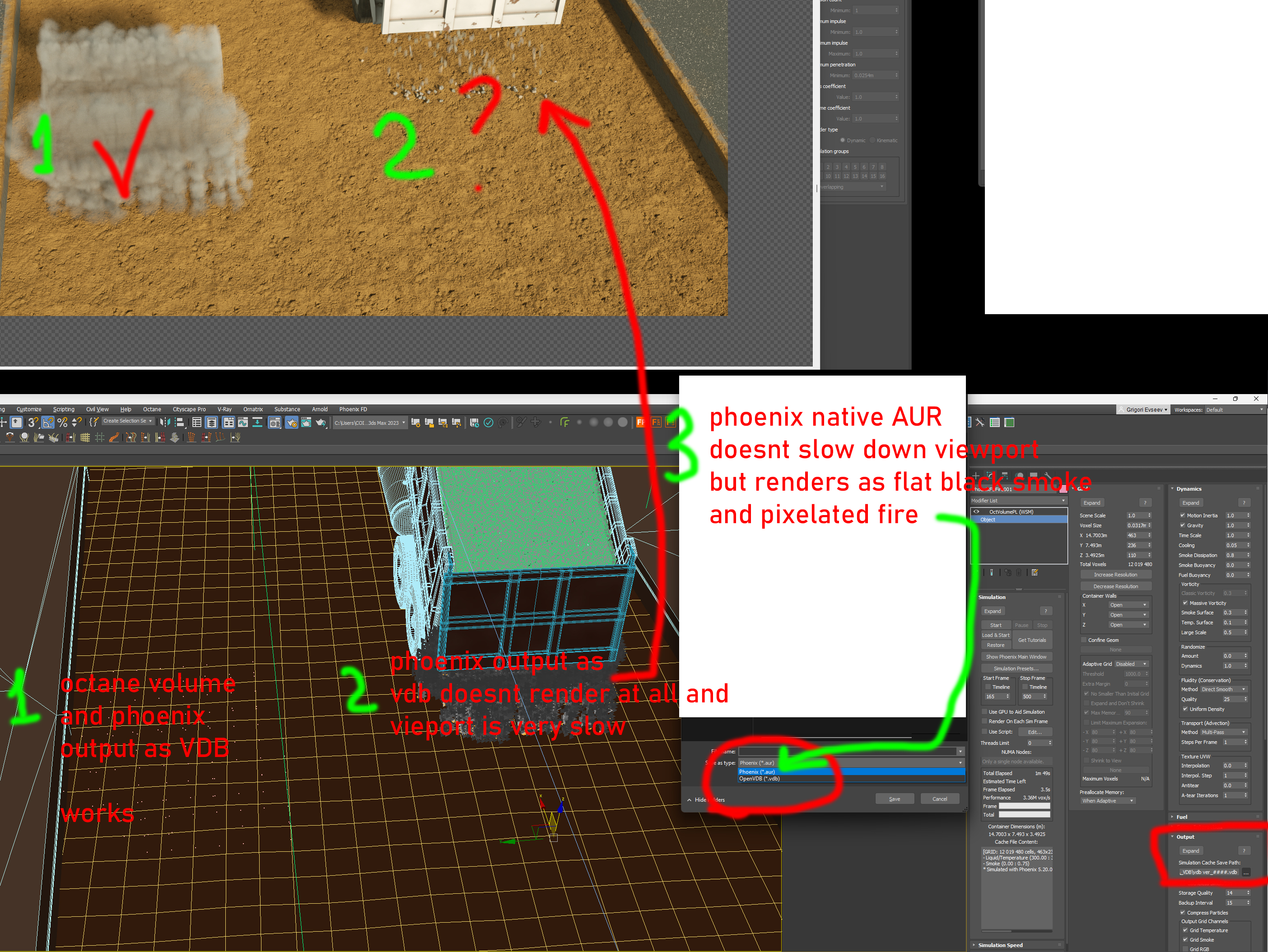

coilbook
Posts: 3179
here is additional info.
Phoenix native AUR and octane are having problem rendering proper smoke.
Phoenix output as vdb doesn't render natively inside phoenix grid and viewport is super slow
Also aligning octane vdb volume made with phoenix to phoenix grid is not easy
