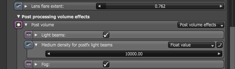

Please explain how to use this setting, it should give the effect of the rays of light sources, but nothing like this happens, I would be glad if you tell me what I do wrong, thank you

Amaterasu wrote:Please explain how to use this setting, it should give the effect of the rays of light sources, but nothing like this happens, I would be glad if you tell me what I do wrong, thank you
From my first experiences with Octane 2023 you need to use new Analytic lights for this.

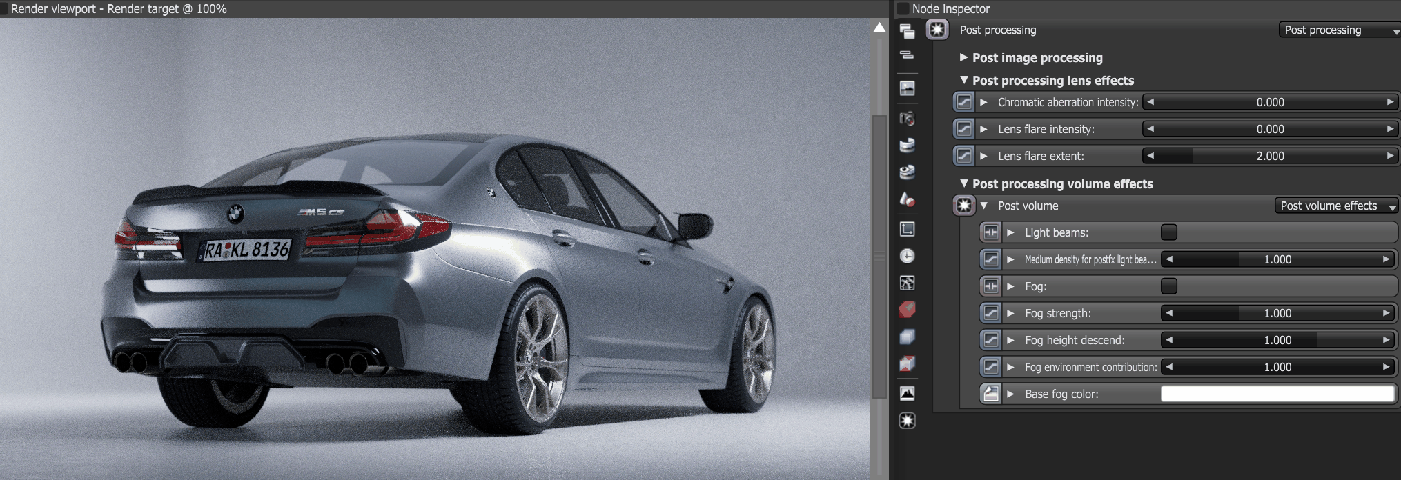

J.C wrote:Enabling "Fog environment contribution" results in funky image.
The attachment Render target.png is no longer available
Fog Environment Contribution --> Lower Value
What is the correct use of "Fog Environment Contribution"?
Can you provide a simplified scene? You can replace the car with a cube, as long as the problem still happens.
I've sent PM as you asked.
Hi there,
You will need to create an analytic/directional light in the scene and toggle on the `User in post volume` bool pin for it to show up in the post volume pass.
