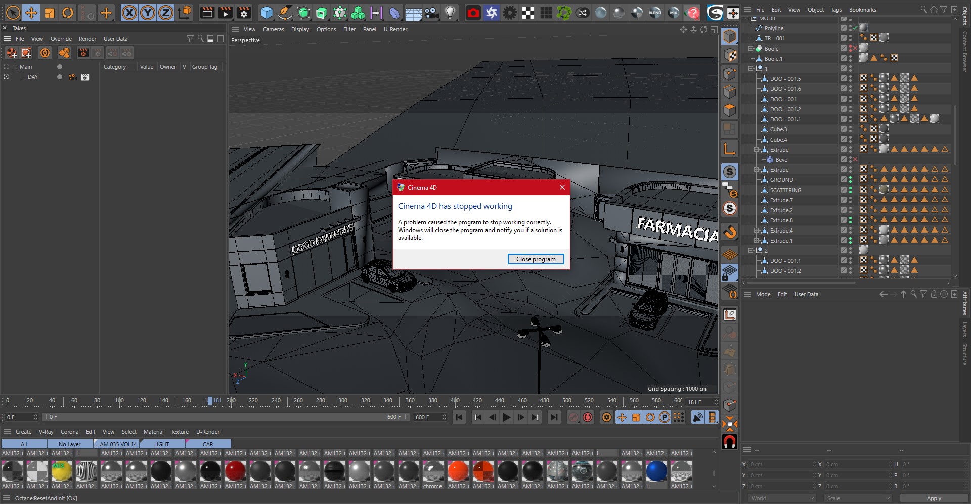

Does anyone run into this situation?
After working with the Liveview window and closing it, C4D stops working and closes after showing an error message.
Not exclusive to the latest version but possibly since v2018 or so, happens in several C4D versions too.

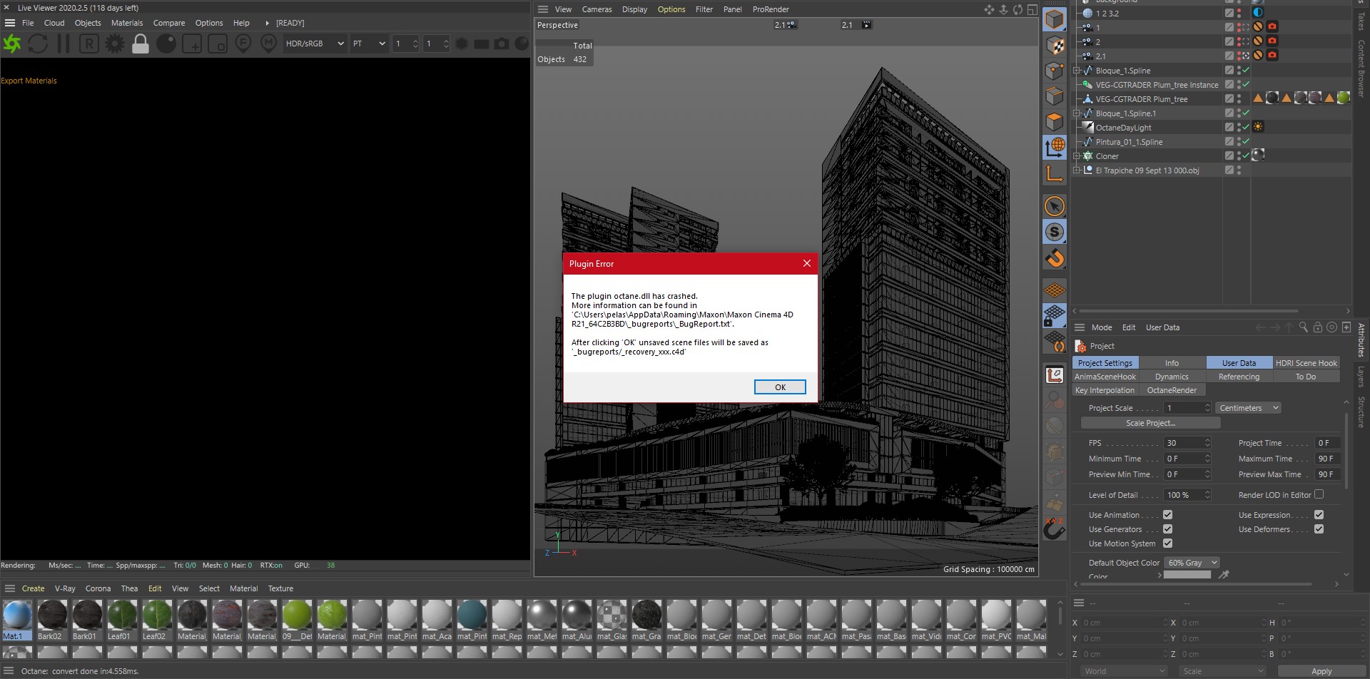

Yeap... definetly something going on with Take systems and Octane (R21 and R23), both Octane 2021.5 R1 and R2. Scene with "Takes" crashes C4D systematically when I start rendering with Liveview window. After deleting all takes, scene began rendering again nicely.
Crash as soon as Liveview window prepares to render

Hi Kalua, as said send me useful data to reproduce your steps. Bugreport+scene+video capture
