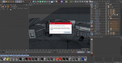

Does anyone run into this situation?
After working with the Liveview window and closing it, C4D stops working and closes after showing an error message.
Not exclusive to the latest version but possibly since v2018 or so, happens in several C4D versions too.
Regards,
Regards,

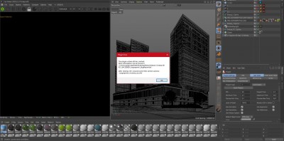

I am having issues, though, with the C4D take system: I don't think it is specifically related to the last Octane build: Sometimes changing one simple parameter from any element makes C4D crash - e.g. changing emissor's power.
I noticed having lots of takes make the file + Octane more unstable (over 10 crashes per day). Did anyone else notice related Take issues?

Hard to tell specifically when it happens,... I have been testing some things now: I have turned off "use texture cashing" and emptied the "texCache". Turns out C4D+Octane usability has improved a lot.aoktar wrote:Could you please give some detailed information with proper data. So I can try to reproduce it! That's the way how we can solve the issues. Thanks!Kalua wrote:Thanks for the build, Aoktar! It works really well!
Regards,
I let you know any news on these crashes.
C4D 2025.1.1 Octane 2025.2.1 v1.5.1, <<2 X 3090 + NVlink>>, Windows 10, X399, AMD TR 1950X, 128 GB RAM, NVIDIA SD 552.22
Yeap... definetly something going on with Take systems and Octane (R21 and R23), both Octane 2021.5 R1 and R2. Scene with "Takes" crashes C4D systematically when I start rendering with Liveview window. After deleting all takes, scene began rendering again nicely.Kalua wrote:Hard to tell specifically when it happens,... I have been testing some things now: I have turned off "use texture cashing" and emptied the "texCache". Turns out C4D+Octane usability has improved a lot.aoktar wrote:Could you please give some detailed information with proper data. So I can try to reproduce it! That's the way how we can solve the issues. Thanks!Kalua wrote:Thanks for the build, Aoktar! It works really well!
Regards,
