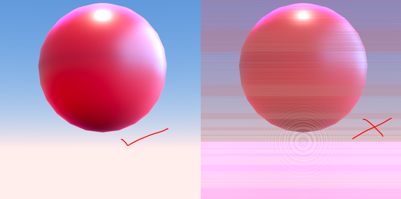

BUG: Weird lines in example with RTX on using 3090
I found another example that renders some weird lines on a 3090 with RTX on. RTX off looks ok.
The camera is in the exact same position as the floor, so its causing problems, but RTX on should look the same as RTX off.

I can confirm the first two bugs are fixed and are from the same issue I fixed last week.
This one is not though and will require some investigation.

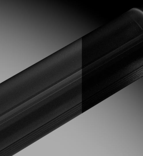

I get some bad results using RTX in conjunction with nesteddialectics and CAD Data:
RTX:

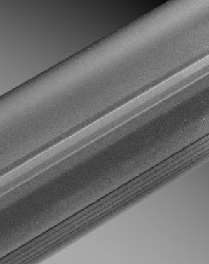

RTX Off
I can't share the scene unfortunately and can't reproduce it in another scene.

I have fixed several issues related to this, pretty confident that it would solve the problem you are seeing in your scene as well. The fix will be in the next release.

same issue for me with RTX on with my 3090, will it be fix soon ? thx

2021.1 RC2 is currently building. It should fix the reported RTX issues. When it has been released, please let us know if the issue has not been resolved - ideally with an example scene. Thank you.
