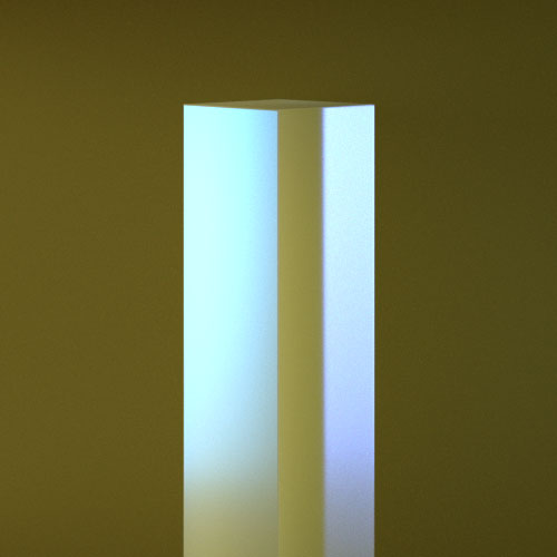

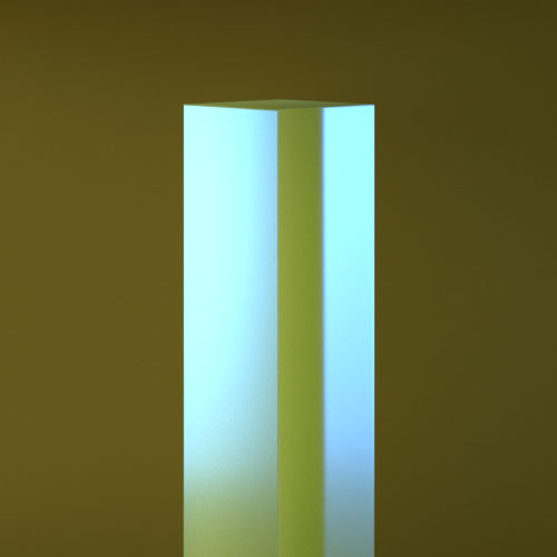

Vijay mentioned a fix for this issue
viewtopic.php?p=402303#p402303
I think it may be part of the "Fixed incorrect denoiser output in scenes with SSS materials.", but I'm still seeing a color difference in the denoised output.
It's not as drastic now, but the denoised output is a bit more blue.
