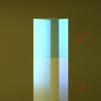

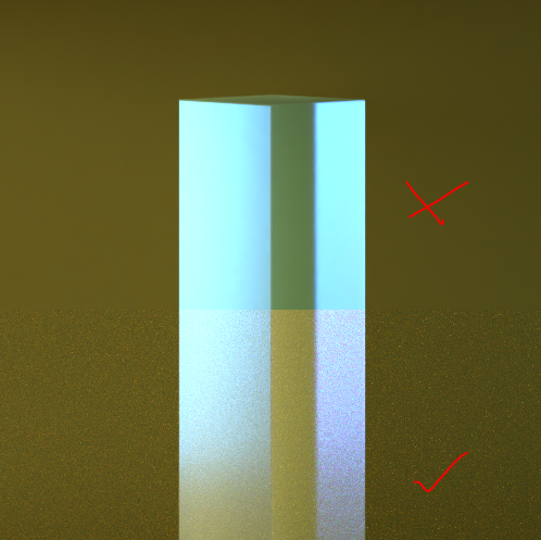

BUG: Color difference between denoised and beauty in this scene
This scene has a big color difference between the beauty and denoised version in 2021. I'm not sure which one is actually correct. The denoised version has a blue tint.
If I load the scene in 2020.2.x it renders a bit differently, but both the beauty and denoised version have a blue tint.
I'm going to guess the blue tint should be in the 2021 beauty pass.

funk wrote:BUG: Color difference between denoised and beauty in this scene
The change in the main pass between 2021 and 2020.x was due to a fix in the medium calculation. So the 2021 build renders correct and the denoiser output is incorrect. The difference is now fixed and the fix will be in the next release.
