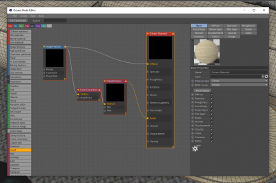

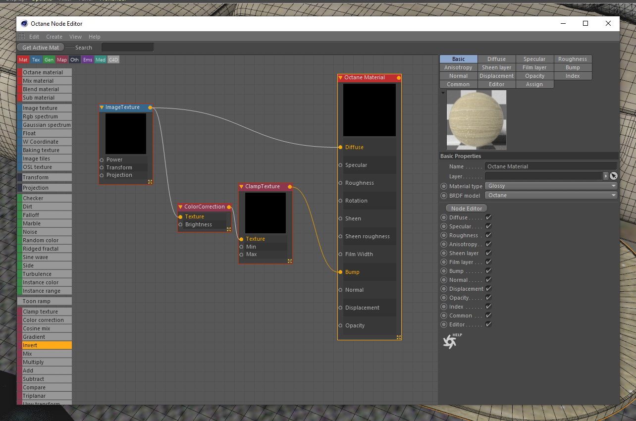

Octan node editor not showing previews. It will show, it will not show. Very unstable. Why is there no preview of the color correction node and other nodes? We have to change the parameters at random. Changing the hue parameter by one out of five times leads to a cinema crash.
https://drive.google.com/open?id=1qtplF ... 08cJhCO33W
eyeonestudio
Posts: 335
Joined: Fri Oct 18, 2013 5:49 pm
Location: Seoul, South Korea
Thank you for your effort. ...
C4D R2026 / Win11 / AMD TR WX Series / 256Gb RAM / RTX 5090 FE / 100GbE
Posts: 16068
Location: Türkiye
divasoft wrote:Octan node editor not showing previews. It will show, it will not show. Very unstable. Why is there no preview of the color correction node and other nodes? We have to change the parameters at random. Changing the hue parameter by one out of five times leads to a cinema crash.
It happen only when LV is not open. I'll take a look

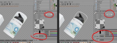

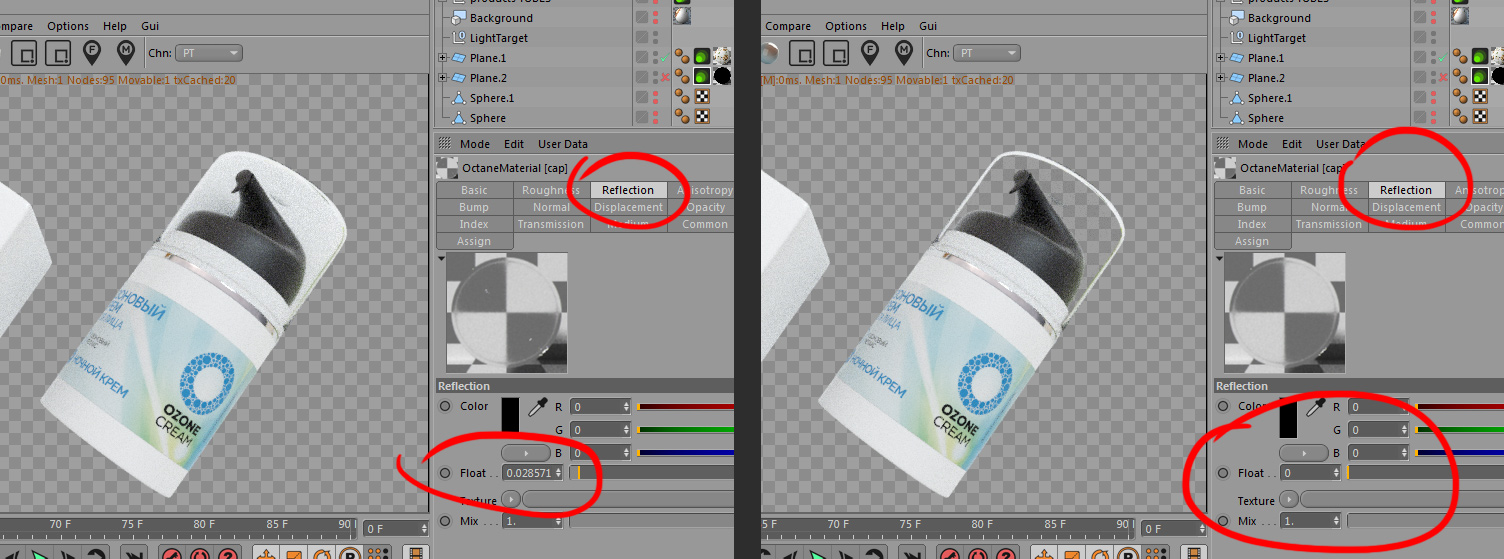

Have no alpha using Affect Alpha in SpecMat. Rendered with Render Layer (Upd.: the same result w/o RL).
Please, see pic
upd.: Have found only way to get alpha in SpecMat is to turn completely Off reflection chanel. Even if the mat has a small amount of reflectivity, there will be no alpha in SpecMat.
Thank you
