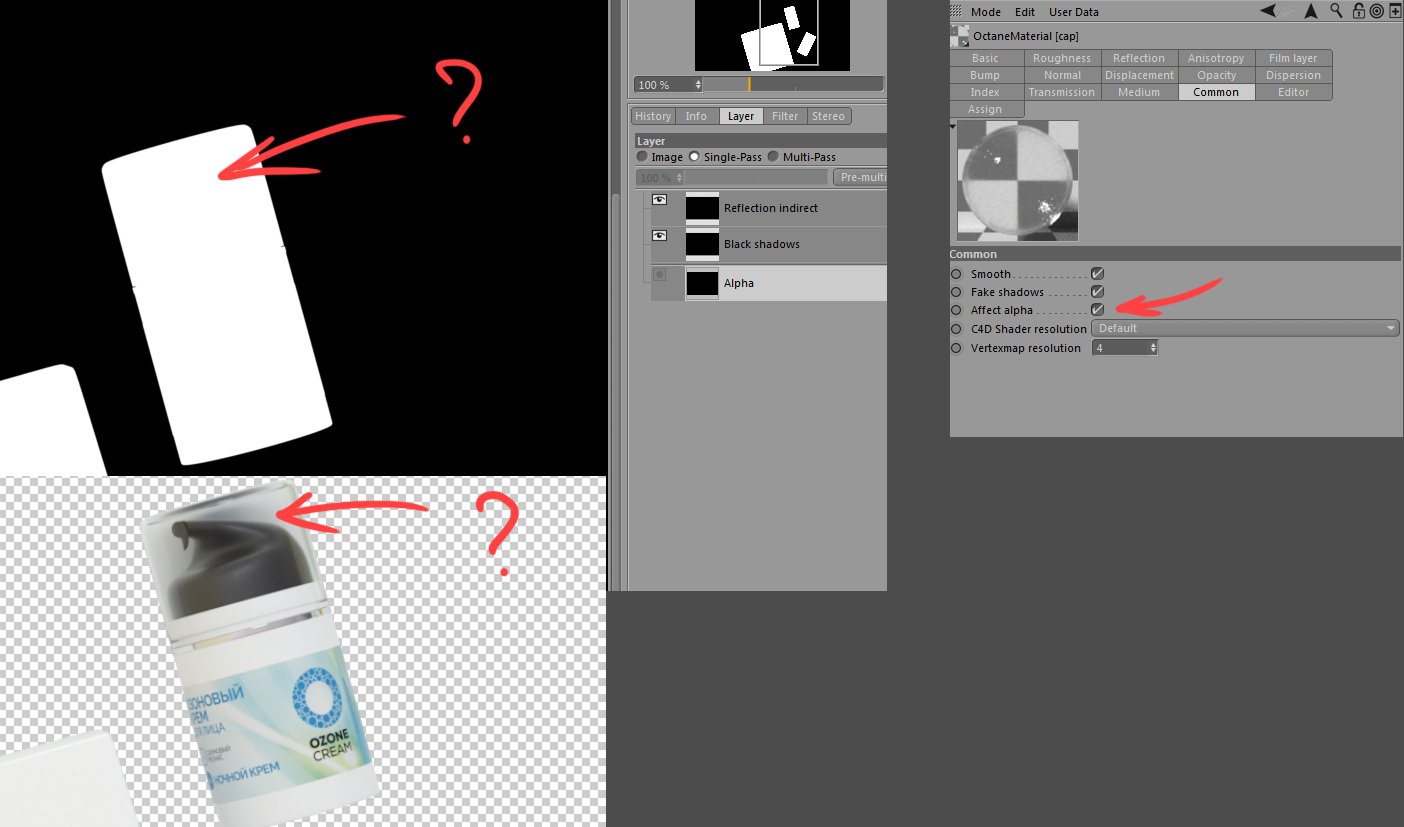

Have no alpha using Affect Alpha in SpecMat. Rendered with Render Layer (Upd.: the same result w/o RL).
Please, see pic
upd.: Have found only way to get alpha in SpecMat is to turn completely Off reflection chanel. Even if the mat has a small amount of reflectivity, there will be no alpha in SpecMat.
