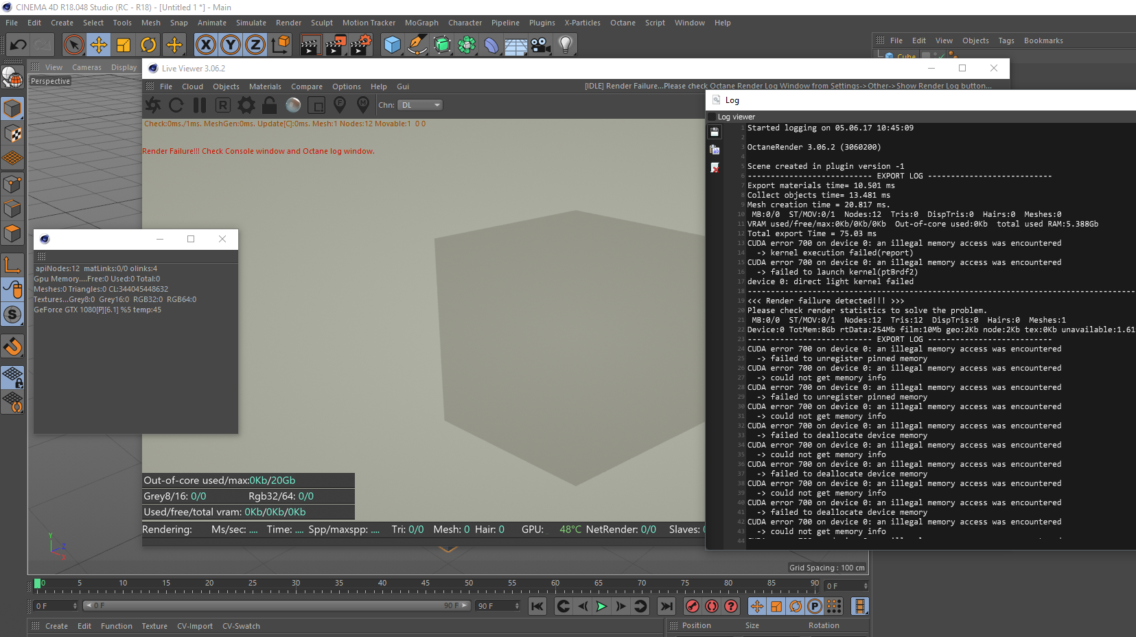

Hi I keep having this issue as well, maybe it's an issue with the card? I'm using a single 1080
viewtopic.php?f=30&t=60347&p=309252&hil ... +0#p309252
octane 3.06 170605 102026.log
(11.8 KiB) Downloaded 232 times

Hi Beppe,
I've installed 3.06.2 and the same issue. this is happening with a default cube in a scene. I've a Geforce gtx 1080 driver version 382.33. Does anyone know how i might be able to check whether it's the card that is failing or Octane?
Thanks,
giz
octane 3.06.2 170605 104727.log
(11.48 KiB) Downloaded 232 times
Posts: 10514
Hi giz,
sorry to hear that you have so many issues.
What happen if you start the Standalone?
Are you able to render without CUDA error?
Just right click in the node graph, create a matetial node, right click on it and choose Render.
What are the exact specs of your machine?
Have you tried to make a clean installation of the Nvidia drivers?
Could you also share a bugreport.txt file?
ciao beppe
