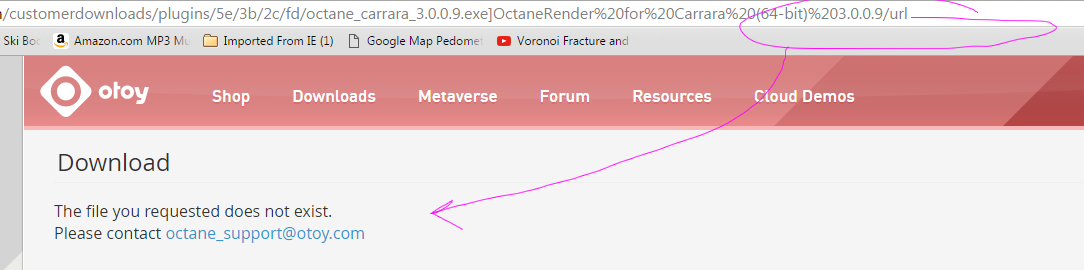

I am unable to download this version. Every time I try to follow the url it leads to an error message. Any assistance is appreciated. Thanks.
- rashadcarter
- Posts: 71
- Joined: Thu Sep 11, 2014 1:16 am
I'm an idiot sometimes. Solved the download link issue. No worries.
