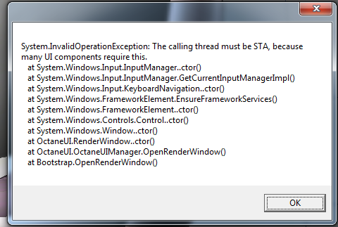

Hi Simon,
Seem to encountered a gremlin when trying to launch the new preview. Please see attached.
Sighman
Posts: 1112
Joined: Thu Jan 19, 2012 9:11 am
Location: Calgary, AB
Hmm, Never tested preview. Always went straight to render.
However, I cannot reproduce this issue. What exactly are your steps to get Carrara to crash?
Win8/64, I7-4770K (3.5Ghz) 24GB, GTX-980ti (6GB) / GTX-TITAN (6GB)
protovu
Posts: 476
Joined: Thu Sep 11, 2014 7:30 pm
Hi Simon,
Actually, by "Preview" I was referencing the forum subject header, "OctaneRender for Carrara 3.0.0.6 [Preview]", and its associated download version,
which I installed.
The SystemInvalid....screen popped up when I launched Octane the usual way, Ctrl+Shift+R, or through the Edit dropdown equivalent command.
My nvidia driver is up to date. 10.18.13.6472
Sorry for the confusion. Oddly, what happened when seeing the pop up was not a crash in the usual sense. Simply, Octane would not launch. Though I did not test it much, and quickly
reverted to 2.25.0087, Carrara seemed normal.

Works fine for me, I have 3 cards one for interface 2 others for rendering.

Hi Simon,
Apparently, Ctrl+Shift+R , for me anyway, does not work - gives me the previous pop-up, but once selecting the Octane renderer in the render room (as you instructed) , Ctrl+R does launch an Octane render.
As you indicated, the render viewport has no stat. data.
Also, there is no way to select the focus point, and no way to access the Live Data Base, area render, and anything else nested in the normal Octane render viewport.
I am wondering if other users are able to access the traditional Octane viewport, and optionally use the Carrara Render room (absent the normal Octane selections). This would allow
normal fine tuning while working, and later batch queue rendering.
Forgive my ignorance on this regarding how difficult it may be to code: If possible, it would be terrific to avoid the Carrara render room altogether, and have the batch queue option nested in the traditional Octane render viewport. This would allow the workflow Octane provides, and scheduled renders.

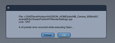

Finally, - getting Octane to work through the Carrara Render room seems to have killed the viewed file. That is, once viewed through Octane via Carrara Render Room, and then reverting to Octane 2.250087, the file will not open, and the provided error message appears. This eliminates an option I was considering: work in 2.25 for normal Octane workflow, then install 3.0 to batch render at the end of the day.
Thank you,
Rick
Sighman
Posts: 1112
The render room rendering is only meant for 'final' rendering and batch queue rendering. It also allows you to render to an avi which you cannot do with the viewport. It certainly does not have any of the dynamic options of the viewport nor is it meant to. You should not use ctrl-shift-R from the render room, it should be disabled. Only open it from the assembly room. The octane viewport should be fully usable at any time except when rendering in the render room.

Actually, from the very start, I was attempting to access the Octane viewport through the Assembly Room, not the Render Room.
Just re-installed 3.0.0.6 to check a 3rd time. Same result:
The System.Invalid pop-up with Crtl+Shft+R, or using the Edit>drop down Octane launch command.
From the Assembly Room, this pop_up comes up regardless of whether the Octane renderer is selected in the Render Room, or not.
I did the test with a fresh file, with a single sphere. The fresh file, does render with Octane using the Crtl+R command, but the hdri background did not show. (Might have missed a setting?)
The test file (attached) is not backward compatible with Octane 2.25.
Suggestions? Trying to figure this......my Carrarra behaves well, and my Octane 2.25 behaves well. No one else has reported lack of access to the new 3.0.0.6 viewport?
