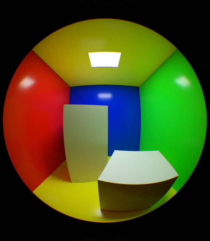

Very nice work. Thanks for sharing results. Do you mind sharing the settings for the fisheye-box as well as the camera adjustments.
So far we gather that the material is specular and added to a 10x10x1 box/plate that's placed before the camera.
Adjustment to IOR and focal length along with dispersion to get the real lens look.
Posts: 10611
Tugpsx wrote:Very nice work. Thanks for sharing results. Do you mind sharing the settings for the fisheye-box as well as the camera adjustments.

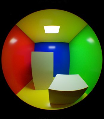

Posts: 10611
hi,
here is a fisheye lens scene in c4d, ocs and orbx format.
in standalone you need to copy the camera position in the placement node of the glasslens or use the marcus Lua script for the foggy inverted sphere. With an integrated plugin it's more easy and you can navigate the scene with fisheye in real time ;)
ciao beppe
FishEyeCornell(bepeg4d).zip
(152.62 KiB) Downloaded 284 times

bepeg4d wrote:hi,
ciao beppe
thanks for sharing mate. ;) ;)

Thanks for this. One question - is there any way to remove the small cube from appearing in reflections on other objects, while still being able to retain the fisheye effect?
Freelance Motion & Graphic Designer
Cinema 4D R19| Win 10 Home 1803 | 4X GTX TitanX 12GB Maxwell | Intel Core i7 5930K 3.5GHz | 48 GB DDR4 -2133 RAM
Tugpsx
Posts: 1180
Location: Chicago, IL
Are you referring to the mesh light? Light source can be adjusted
