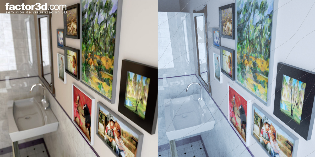

PAQUITO wrote:
glimpse wrote:The Only question, how You manage to remove that tint (usually blueish)?
I guess you are talking about the blueish tint you get in DL when using the sky environment. In this scene I use a blue emitter combined with a white environment. Also I use to make a white balance at the end (with the white point tool).
Yeah, exactly 'bout that!
Thanks for tip, Paquito =)

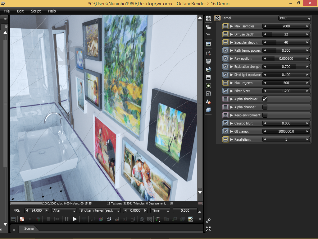

Hey resmas, what is that GI clamp thing you are talking about?

PAQUITO wrote:Hey resmas, what is that GI clamp thing you are talking about?
Hi mate, the GI Clamp its a option in PT kernel. Most of the times I use DL (AO and Difuse) but sometimes I need Path Tracing and in there we have the GI Clamp that gives faster results.
If you want I can remove the images I posted earlier, this is your post so just let me know if you want them removed.
Once again thx for your file. I will try to post a shoot.

nuno1980
Posts: 823
Joined: Sat Dec 18, 2010 10:04 pm
PMC kernel@22-diffuse,@40-specular depth running GTX 670 (until buy GTX 980 xD)
Imager:
-dscs315_2
-exposure 2
-gamma 1.6
:D
Do you like my image? ;)
--Learns/tips before buy my image:
PT vs PHT kernels - spp nrs
Caustics at PT
TRUE spec materials w/ dispersion
NOTE: Sorry, my bad English for mute ;)
i7-12700KF
32GB DDR4@3600
GF RTX 4090 <3 :mrgreen:
NEW ViewSonic XG2431 24" :D
PAQUITO
Posts: 463
Joined: Wed Nov 21, 2012 4:50 pm
Location: Spain
Yes, I like it, and the image is good. Now, you spent 15 minutes versus something like 1 minute or less for my image. And putting them side by side, I can´t see why I must consider the PMC version better than the DL version. To me are nearly identical (appart from the color balance and exposure).

nuno1980
Posts: 823
PAQUITO wrote:Yes, I like it, and the image is good. Now, you spent 15 minutes versus something like 1 minute or less for my image. And putting them side by side, I can´t see why I must consider the PMC version better than the DL version. To me are nearly identical (appart from the color balance and exposure).
I can see the differences between your image and my image (not color balance nor exposure):
your: no caustics very blurry by color... -> bit fake photorealism (bit cartoon)
my: caustics very blurry by color... -> true photorealism
Should study about the differences between kernels (DL, PT...) - here and search "kernel".
If you use PT or PMC kernel then should modify the model(s) of material(s) and/or color(s) of material is(are) incorrect(s). ;)

glimpse
Posts: 3740
nuno1980 wrote:I can see the differences between your image and my image..
Nuno, we all see that..but that's not the point.
The client, who pays money, don't care about that difference. So, why to waste more time (taking it from family, kids wife, etc..) when You can spend less time at work or do more at the same time? =)
