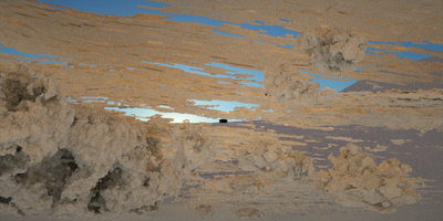

Nice result. If I understand well, these clouds require heavy geometry ? If I want to add this kind of clouds to an already heavy scene close th the VRAM limit, I can't.
I expected clouds to use the fog medium and being shaped procedurally inside a low poly count volume. Is it possible ? I haven't achieved a decent result so far.

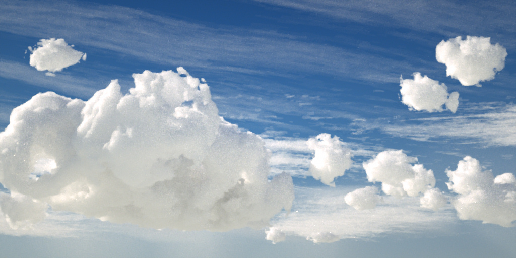

Clouds

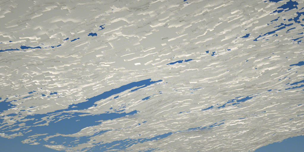

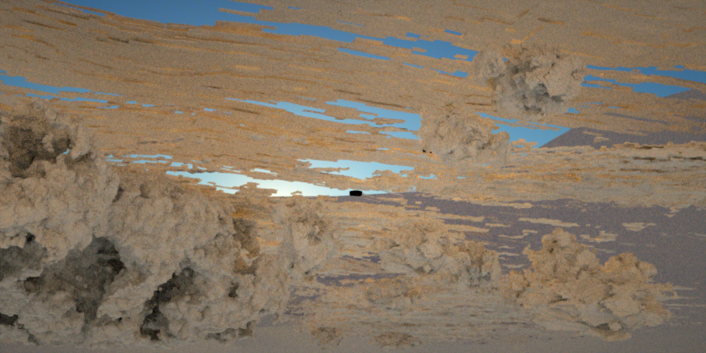

Thanks, here is the model version of the cirrius, Bepeg :
The clouds are some time very high poly, between 100 000 and 1 million polys.
If you don't have to turn around, you can use a low poly model with a texture, the result could be not too bad, I haven't tried it yet.

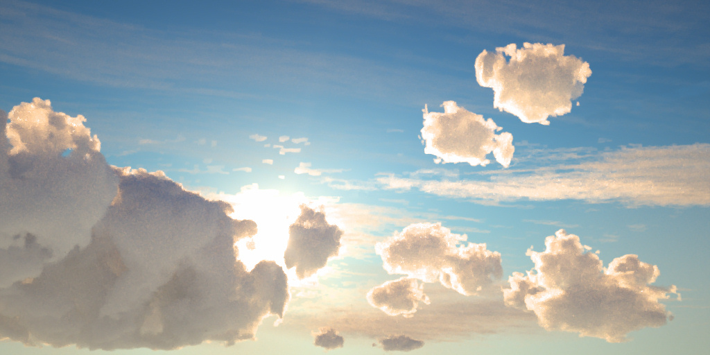

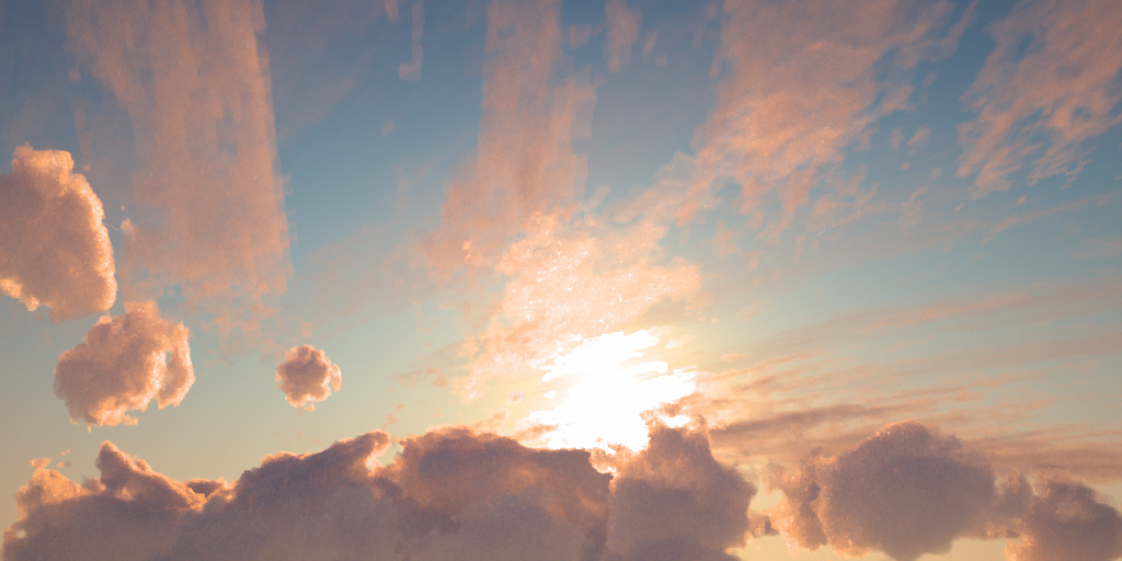

Somet other multiple clouds :
wow, the backlight versions are awesome, thanks

Here is a sample scene.
I principally edit the scale of the scattering node and the scattering_direction value.
