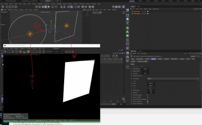

Note sure if it has been mentioned, but if you set the area light to a disc shape, the direction of illumination flips to negatize z, instead of positive z.
Posts: 10635
SilentPartnersStudio wrote:Note sure if it has been mentioned, but if you set the area light to a disc shape, the direction of illumination flips to negatize z, instead of positive z.
yes, Disk primitive is only supported by new Analytic light:
viewtopic.php?f=85&t=82023&p=427165&hilit=disk#p427165
ciao,
Beppe

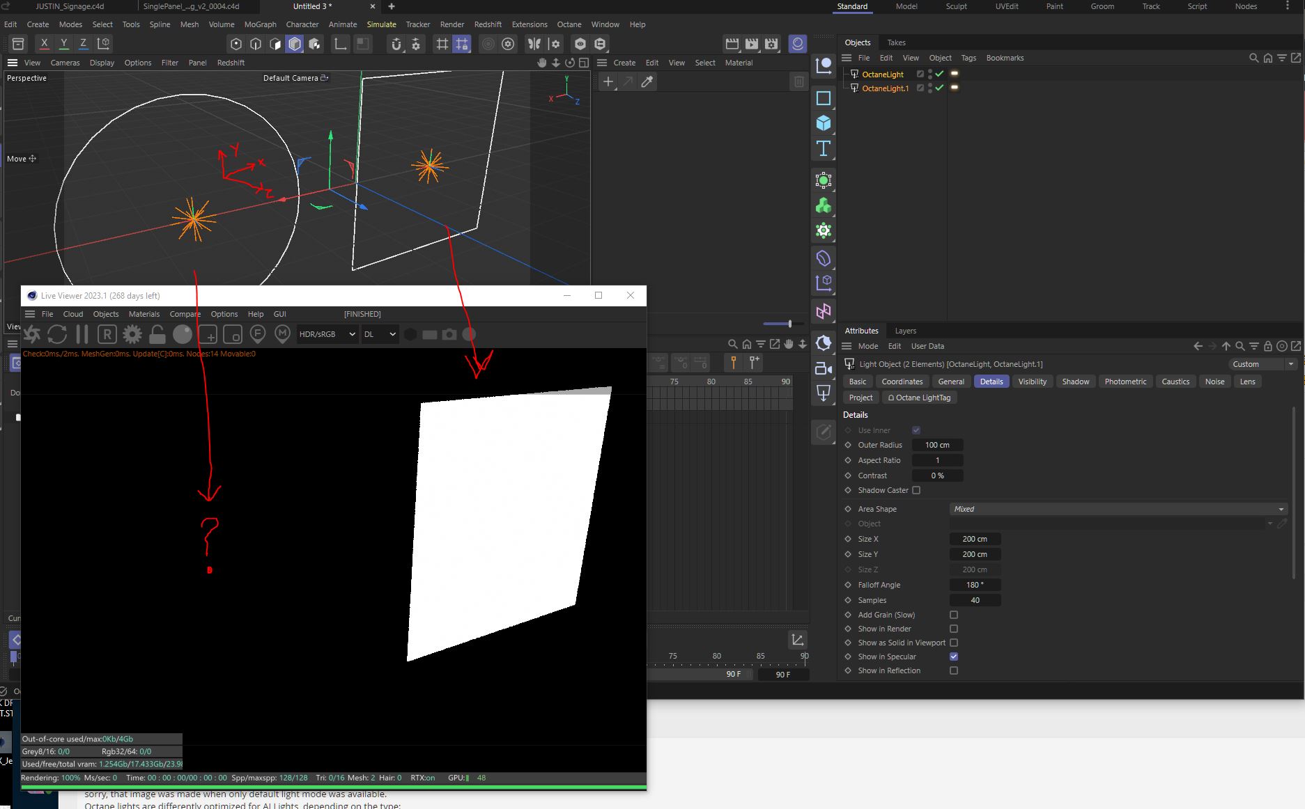

Posts: 12
Joined: Mon Feb 15, 2016 4:38 pm
ciao,
Beppe

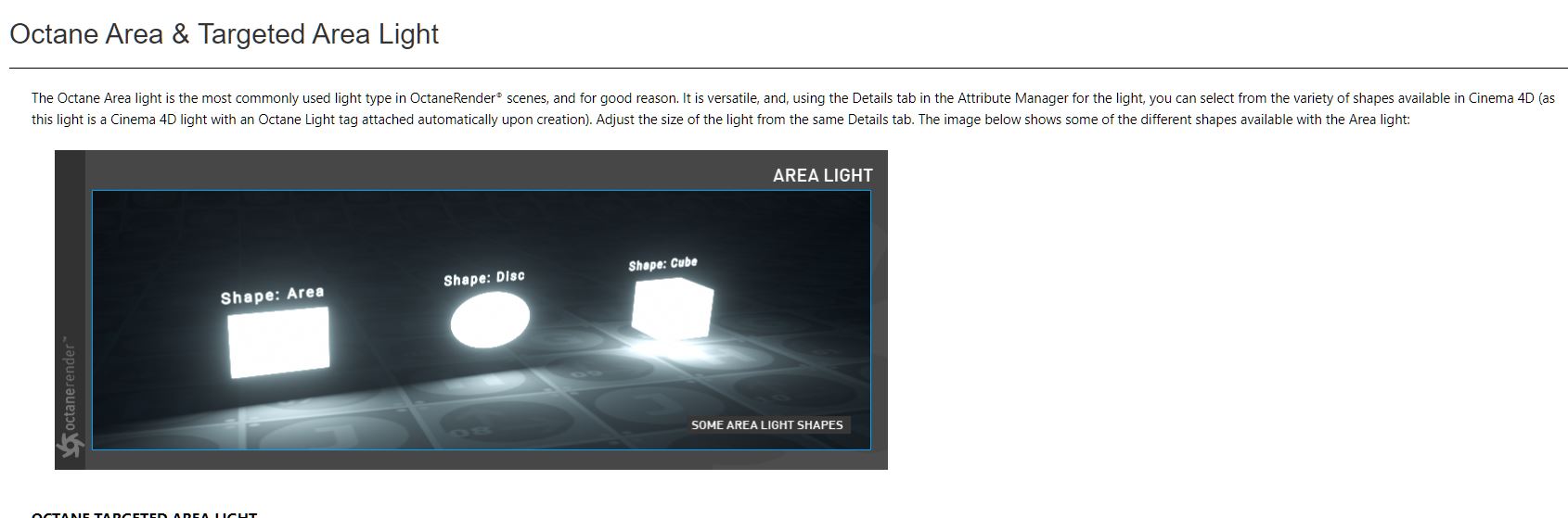

It's interesting, because it is in the documentation, and it works fine if I flip the scale negative on the z axis.
So seems supported, but broken...

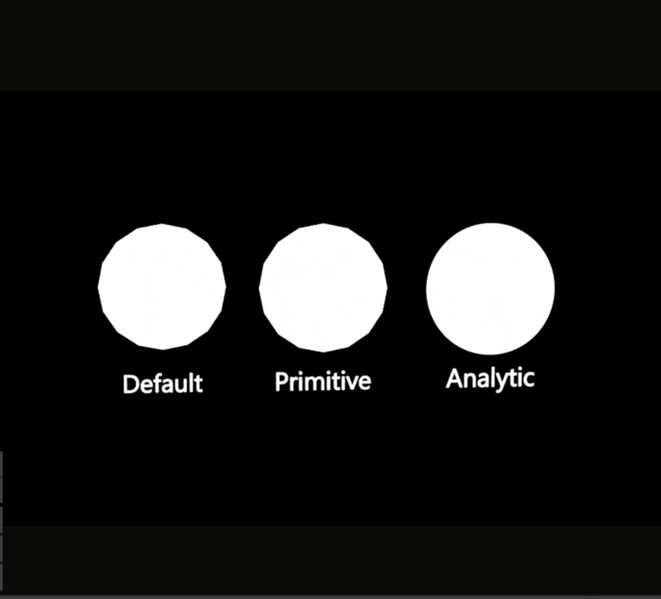

Posts: 10635
sorry, that image was made when only default light mode was available.
Octane lights are differently optimized for AI Lights, depending on the type:
- Default = only Rectangle
- Use primitives = Rectangle, Sphere
- Analytic = Rectangle, Sphere, Disk, Tube
You can use the Default or Primitive modes with Disk Area Light, but it is like using a Disk object with Diffuse Emitter material.
Note that in Default and Primitive mode, you can see the segments of the disk.
ciao,
Beppe

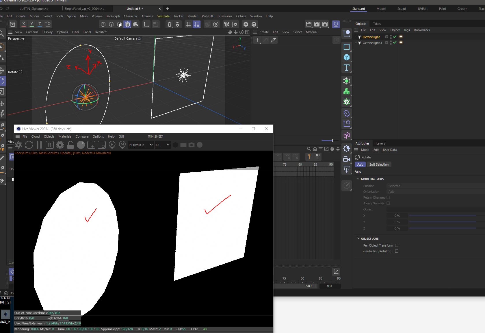

Posts: 12
bepeg4d wrote:Hi,

Correct.
And when I do this, the direction is reversed.
both the same:
disc rotated +180:

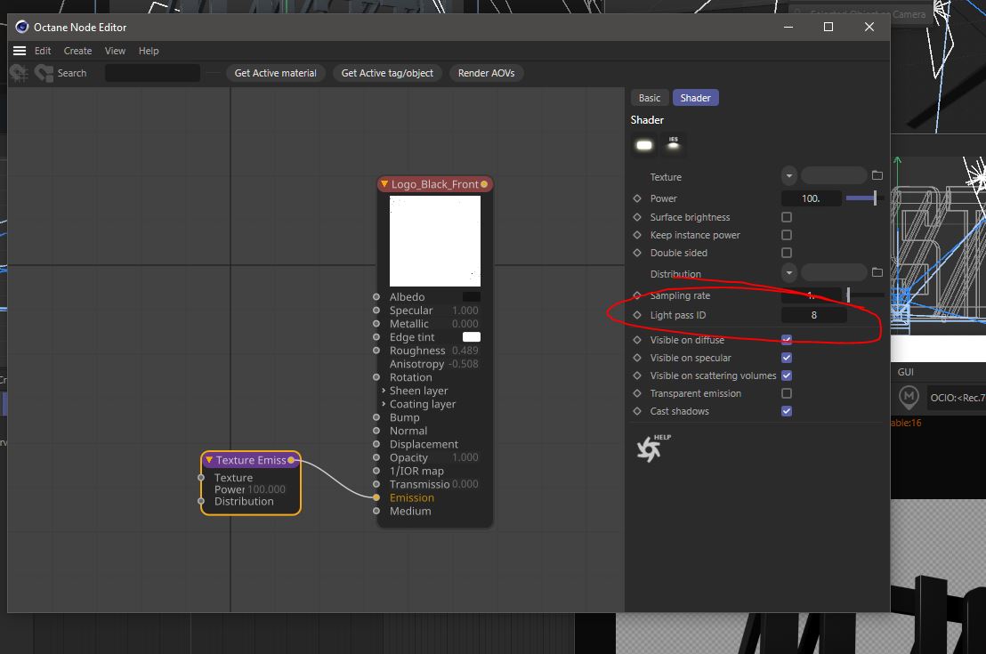

Posts: 12
In the texture emission, the lightpass attribute has not been adjusted to accept values higher than 8.
