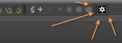

I made some Octane Icons for my 3dsMax main toolbar. If anyone wants to use them go ahead.
@KilaD if you find them usable you are welcome to add them to the script in your next update.
