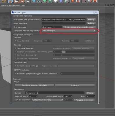

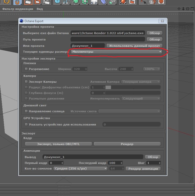

add the units, please in the version 3d max
kilaD
Posts: 215
Joined: Sun Mar 21, 2010 12:34 pm
Location: Norway
Elvis is back!
Why add this, the scale is converted to meters automatically. Do you have a reason for this request?
