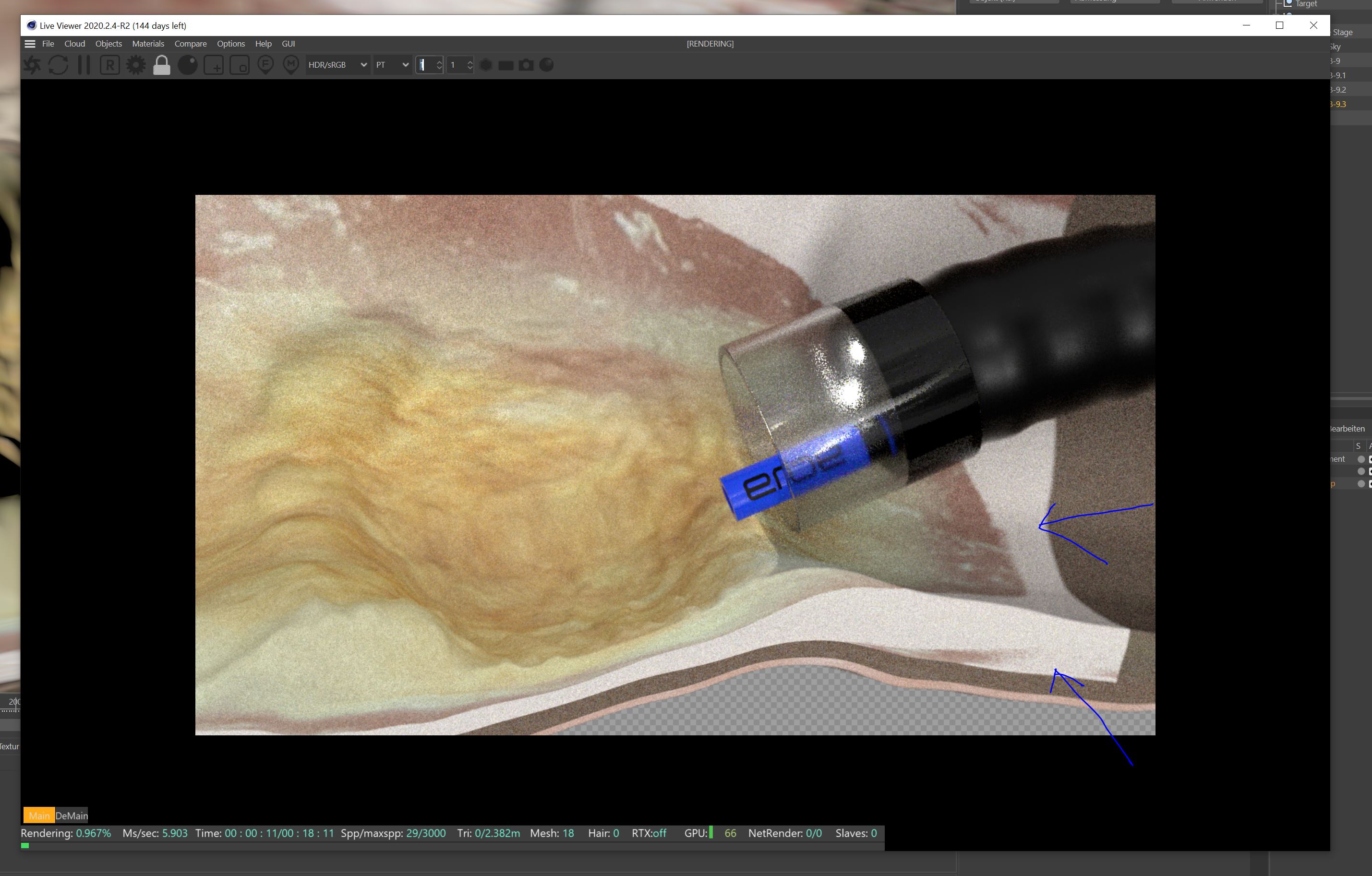

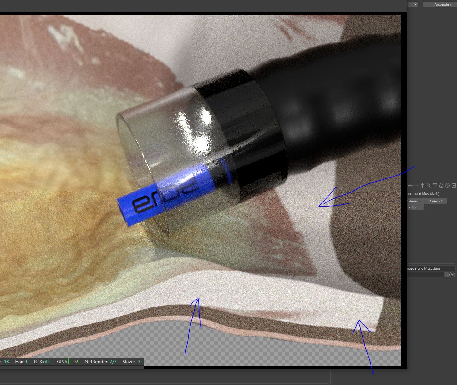

Bug with Vertex Map as Alpha in Composite Material. The vertex maps do not work in a composite material. With the older version 2020.2.1-R3 with the same settings is no problem.
I use Cinema 4d R23
Posts: 16068
Location: Türkiye
erbe wrote:Bug with Vertex Map as Alpha in Composite Material. The vertex maps do not work in a composite material. With the older version 2020.2.1-R3 with the same settings is no problem.
I use Cinema 4d R23
What happens with 2020.2.4?
erbe
Posts: 9
Joined: Thu Nov 17, 2016 10:23 am
There is the same problem. :?
Posts: 16068
Location: Türkiye
erbe wrote:There is the same problem. :?
Please send me a sample scene and enough info to describe the issue.
erbe
Posts: 9
I send you a small example from the problem. It is Blend material with a vertex map as alpha.
Vertex Test.zip
(119.4 KiB) Downloaded 305 times
erbe
Posts: 9
Does anyone have any ideas about the problem?
Posts: 16068
Location: Türkiye
erbe wrote:Does anyone have any ideas about the problem?
Connect it to mask2 and rename to "Vertex map" from "Vertex-Map". You can see mask1 is doing nothing if you use with any different texture. Also Vertex Map's are name sensitive since last builds and doesn't accept exceptional characters.
