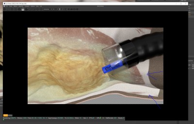

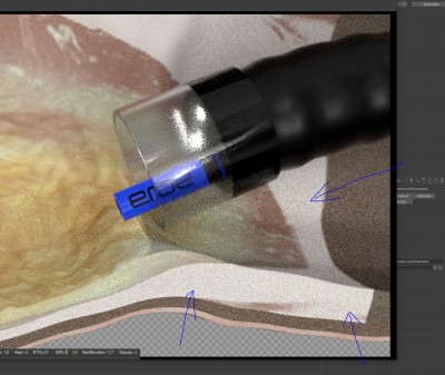

What happens with 2020.2.4?erbe wrote:Bug with Vertex Map as Alpha in Composite Material. The vertex maps do not work in a composite material. With the older version 2020.2.1-R3 with the same settings is no problem.

I send you a small example from the problem. It is Blend material with a vertex map as alpha.

Connect it to mask2 and rename to "Vertex map" from "Vertex-Map". You can see mask1 is doing nothing if you use with any different texture. Also Vertex Map's are name sensitive since last builds and doesn't accept exceptional characters.erbe wrote:Does anyone have any ideas about the problem?
