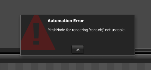

When i set a new project name in the exporter it runs fine but obviously with default materials. But when i go to use an existing project (an earlier exported .obj) and hit render i get this...
I have done many successful animations using older versions of this plugin before.. whats the go?
Whats more weird is that i can just click "okay" on the automation error, click the mesh node in octane and it will render....
tried both f and g of this plugin and last two previous versions of octane with the same result...
Sorry, probably an easy fix but i cant seem to find the solution...

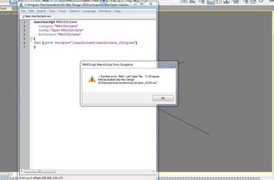

Hello
Elvissuperstar007
Posts: 2545
Location: Ukraine
do not get to run the script
kilaD
Posts: 215
Joined: Sun Mar 21, 2010 12:34 pm
Location: Norway
1.022g should be h. Try to replace the g with a h and save the macro.
