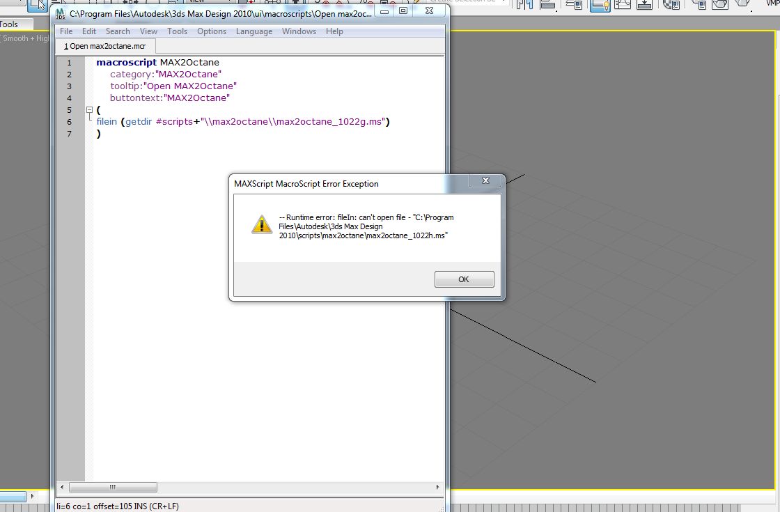

Hello
- Elvissuperstar007
- Posts: 2545
- Location: Ukraine
- Contact:
do not get to run the script
1.022g should be h. Try to replace the g with a h and save the macro.
