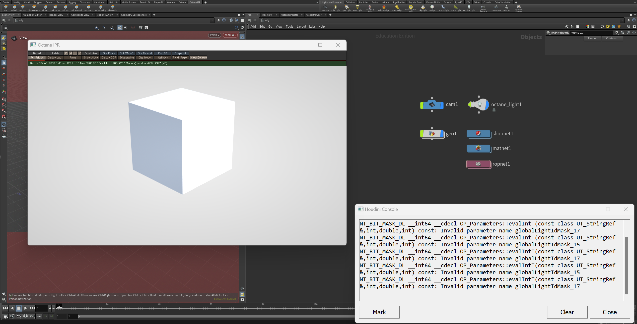

Regarding the errors like: "Invalid parameter name globalLightIdMask_17" i'm getting that in 20.0.547 and the matching version of Octane, is there a way to fix it?

mttsapov wrote:Regarding the errors like: "Invalid parameter name globalLightIdMask_17" i'm getting that in 20.0.547 and the matching version of Octane, is there a way to fix it?
When is that happening, do you have a scene to reproduce this? Do you have the same issue in 2023.1.0.3?
Hi, yes i can reproduce it every time i open my IPR.
Even when i do a Full Reload or an Update from the IPR window
