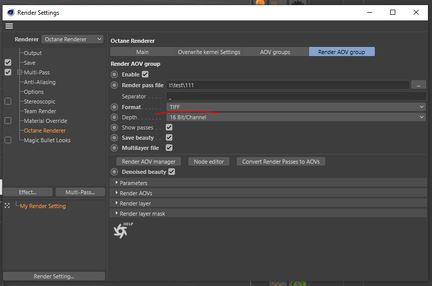

Hello, I'm trying out the new version.
Tell me please, why can't I save any file format other than exp through octane?
If I choose tiff or png in this place, then octane simply does not save anything.

divasoft wrote:Hello, I'm trying out the new version.
It saves here, what are you saving by render AOVs? You have "denoised beauty" checked, any other passes(AOVs)? Please put your scene here.

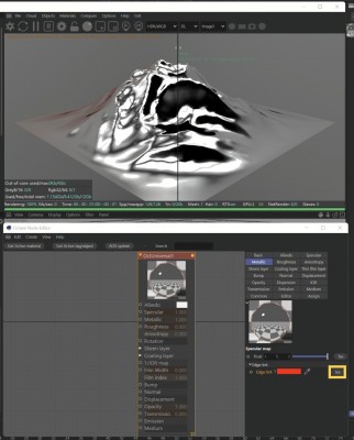

"Edge Tint" doesn't seem to work. And can't connect rgb-texture even in node editor.

eyeonestudio wrote:"Edge Tint" doesn't seem to work. And can't connect rgb-texture even in node editor.
The attachment 2022-07-21_113350.jpg is no longer available
it is working here:
And if you press the Tex button, you can use any kind of texture node, even if the connection/pin is not displayed:
ciao,
Beppe

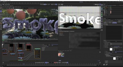

Volume Builder(Fog) + Octane Volume Medium --> O.K
Volume Builder(Fog) + new Standard Volume --> Density channel is not recognized. (also TFD)
New Standard Volume is good feature.
I'd love to be able to use it with Volume Builder(Fog).
If this is possible, it can do a lot. Because a texture can be used for Standard Volume - Density.

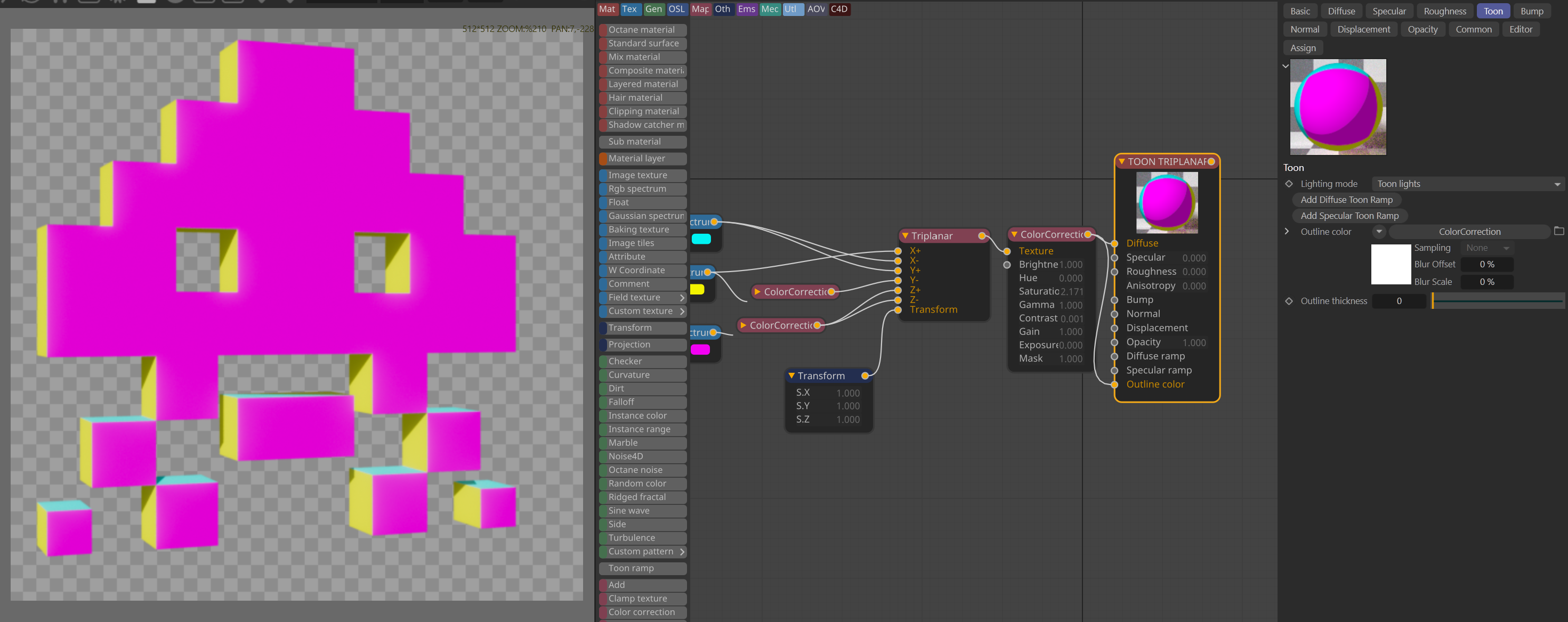

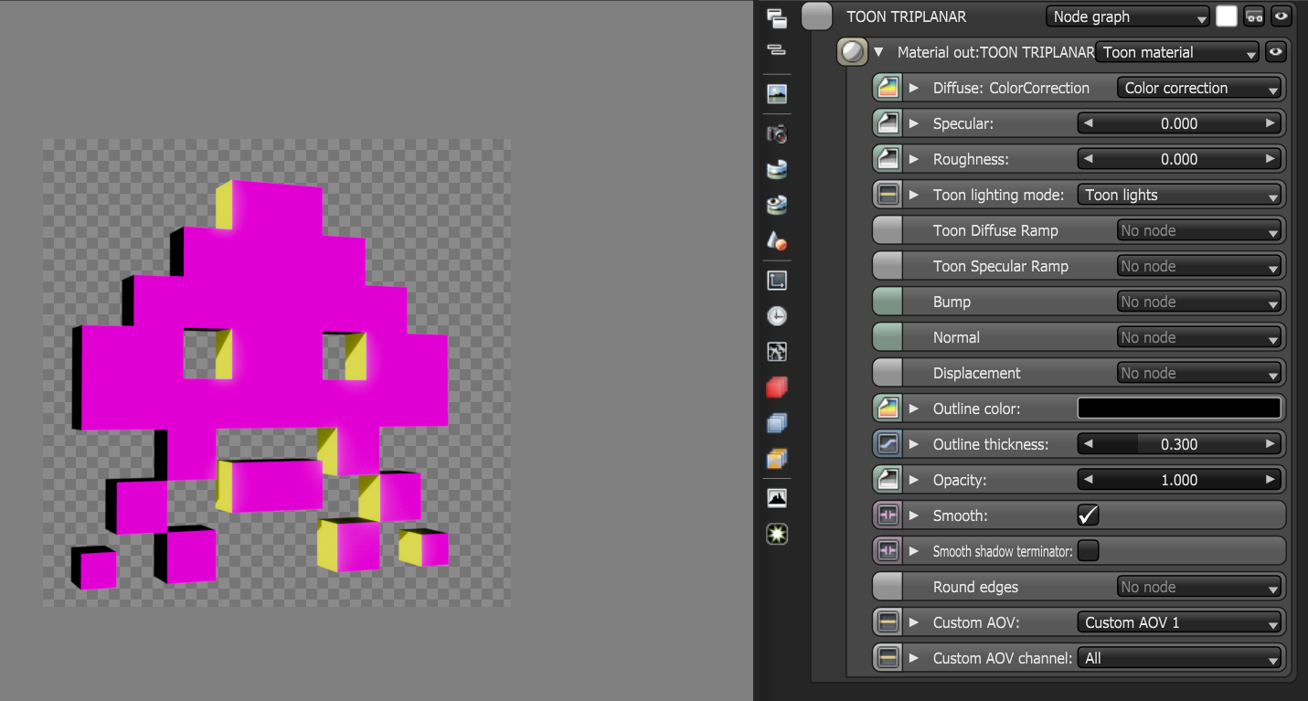

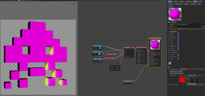

something seems to have broken between C4D and Standalone versions re: Toon shader outlines, a project started in C4D 2022.1 XB1-R3 displays incorrectly in 2022.1 XB2-R1, so I opened it in standalone 2022.1 XB 1 and found that it was completely disregarding all Toon Outline values and adding the default Black 0.3 Outlines, and when I set that back to 0, it looks correct again in standalone, but I cannot get C4D XB2-R3 to do anything with Outlines whatsoever:
displays correctly in C4D XB1-R3
incorrect in C4D XB2-R1, outlines cannot be changed
edit in standalone reveals added default black 0.3 outlines
