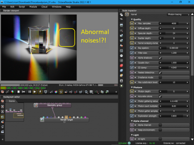

- abnormal noises!?! - at photon tracing – my screenshot: -> "Procedural Prism" ORBX download - https://render.otoy.com/downloads/d4/7c ... sm_01.orbx
--Try any NVIDIA Tuning (RTX 20-serie) or Ampere (RTX 30-serie) videocard - have you not same problem on this ORBX scene?

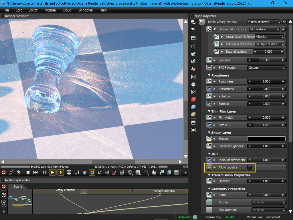

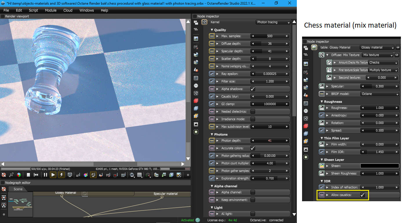

- wrong caustics (less visible) on mix material with “allow caustics” checked like chess material But normal without "allow caustics" on mix material: -> "Chess Procedural with glass material with photon tracing" ORBX download -
