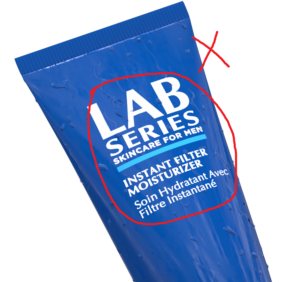

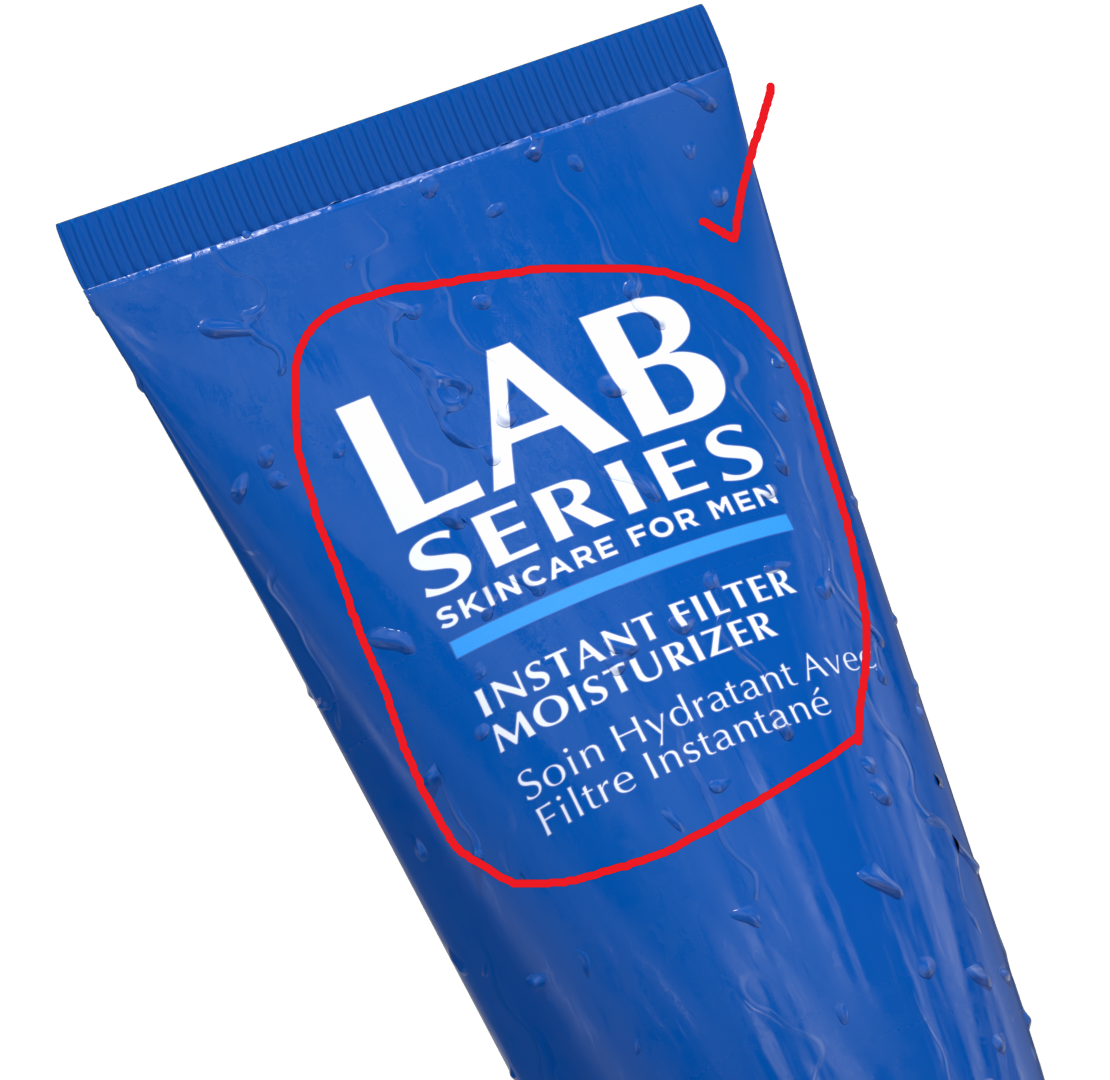

I opened a file that was about a year old and I am seeing an issue where denoising is rendering a text label much thinker than it should be.
The file renders correctly with denoising on Octane 2020.1.5.
The problem appears with latest Octane 2020.2 RC2.
If Devs need ORBX send me info where to upload that (archived file is about 1.12 GB).

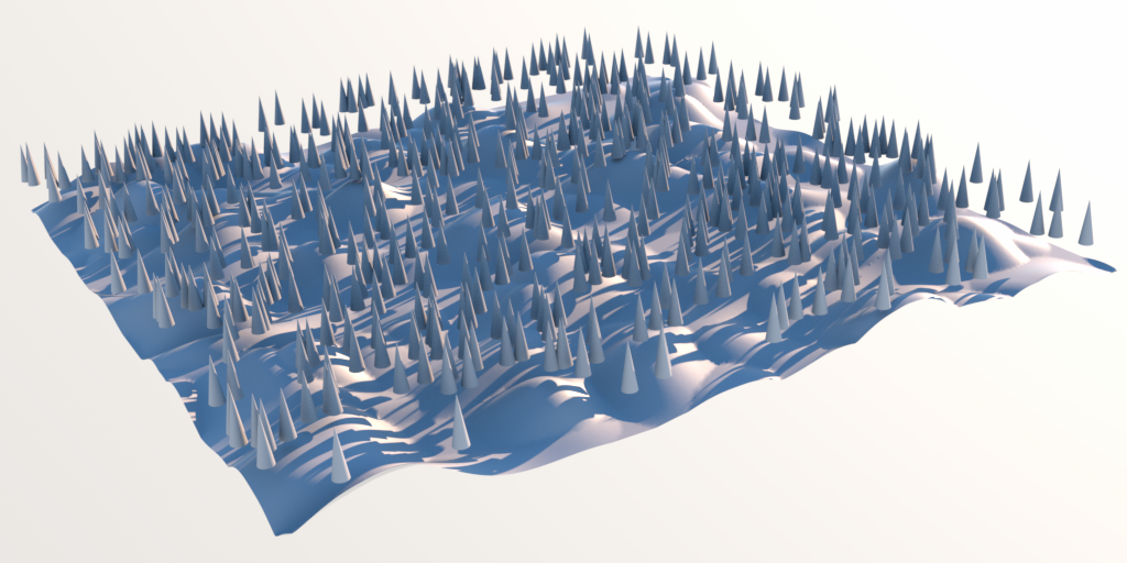

Is there a way I can make the scattered objects follow the displaced surface mesh?
lanklaf
Posts: 79
Joined: Sat Dec 23, 2017 4:22 pm
DamjanMX_1 wrote:Is there a way I can make the scattered objects follow the displaced surface mesh?
Sure,
Connect the same Displacement texture to the Position Shader of Octane Scatter ;)

Regarding scatter and displacement unfortunately the scatter happens on the non displaced mesh. In the case of a terrain you can plug the height map in the translation part of the scatter tool.

jobigoud wrote: Regarding scatter and displacement unfortunately the scatter happens on the non displaced mesh. In the case of a terrain you can plug the height map in the translation part of the scatter tool.
Is there a plan in a foreseeable future to make it able to scatter on displaced meshes?
Thank you and @lanklaf for the tip.

pegot wrote:I opened a file that was about a year old and I am seeing an issue where denoising is rendering a text label much thinker than it should be.
Would you be able to share a minimum repro case for this issue? You may share your file by the means that is most convenient for your and send a PM.
