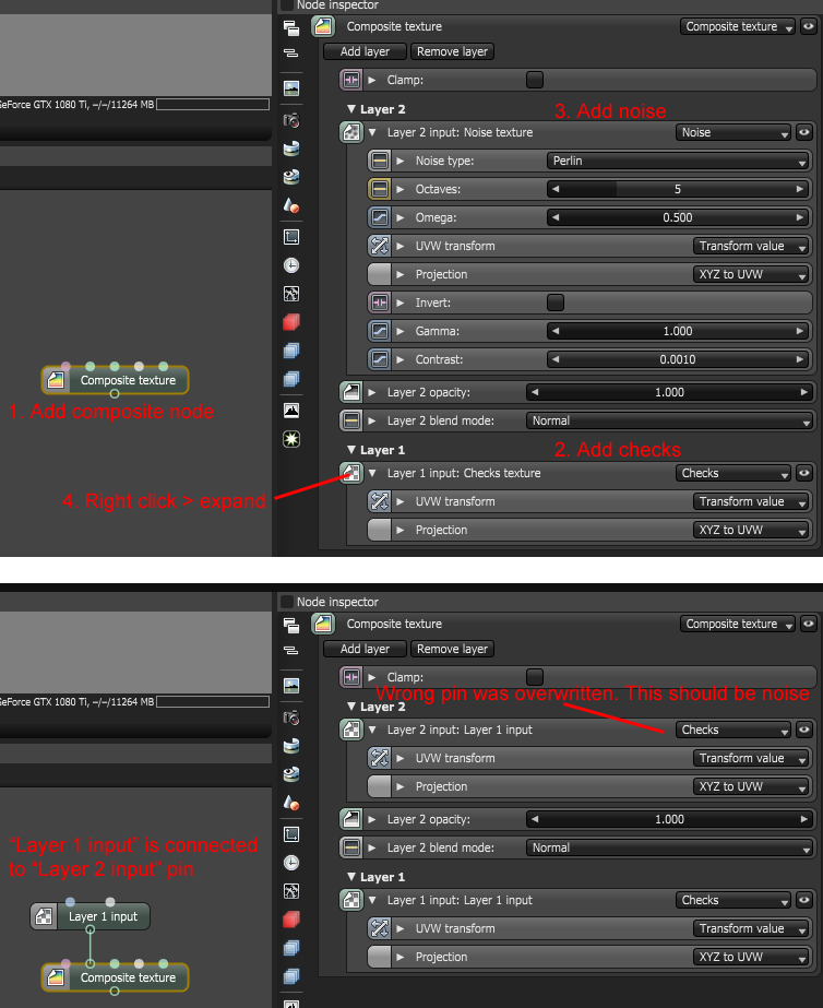

BUG: Composite node overwrites wrong pins when nodes are expanded
I just wanted to add a bit more info to the previous bug I posted here:
viewtopic.php?p=392217#p392217
This bug does not happen on saved scenes which already contain a composite node (I think). It only seems to happen after adding the node and doing these steps:
1. Add a composite texture. NOTE: If you hover over the node inputs, the far LEFT pin is layer 2 input, while right is layer 1
2. In the inspector, set layer 1 input to "checks"
3. Set layer 2 input to "noise"
4. In the inspector, right click the layer 1 input icon > expand
RESULT: The checks node expands but is attached to layer 2 input pin, which is wrong. It overwrites the previously connected noise node.
I added an image to make this clearer.

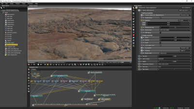

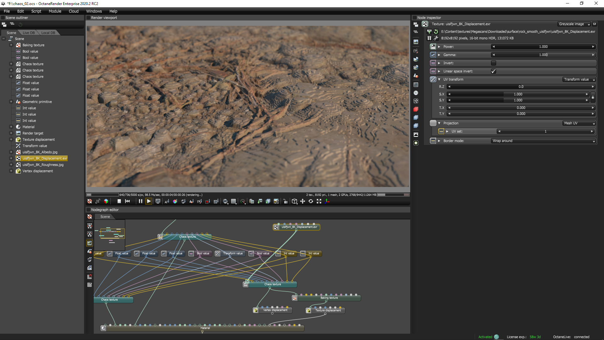

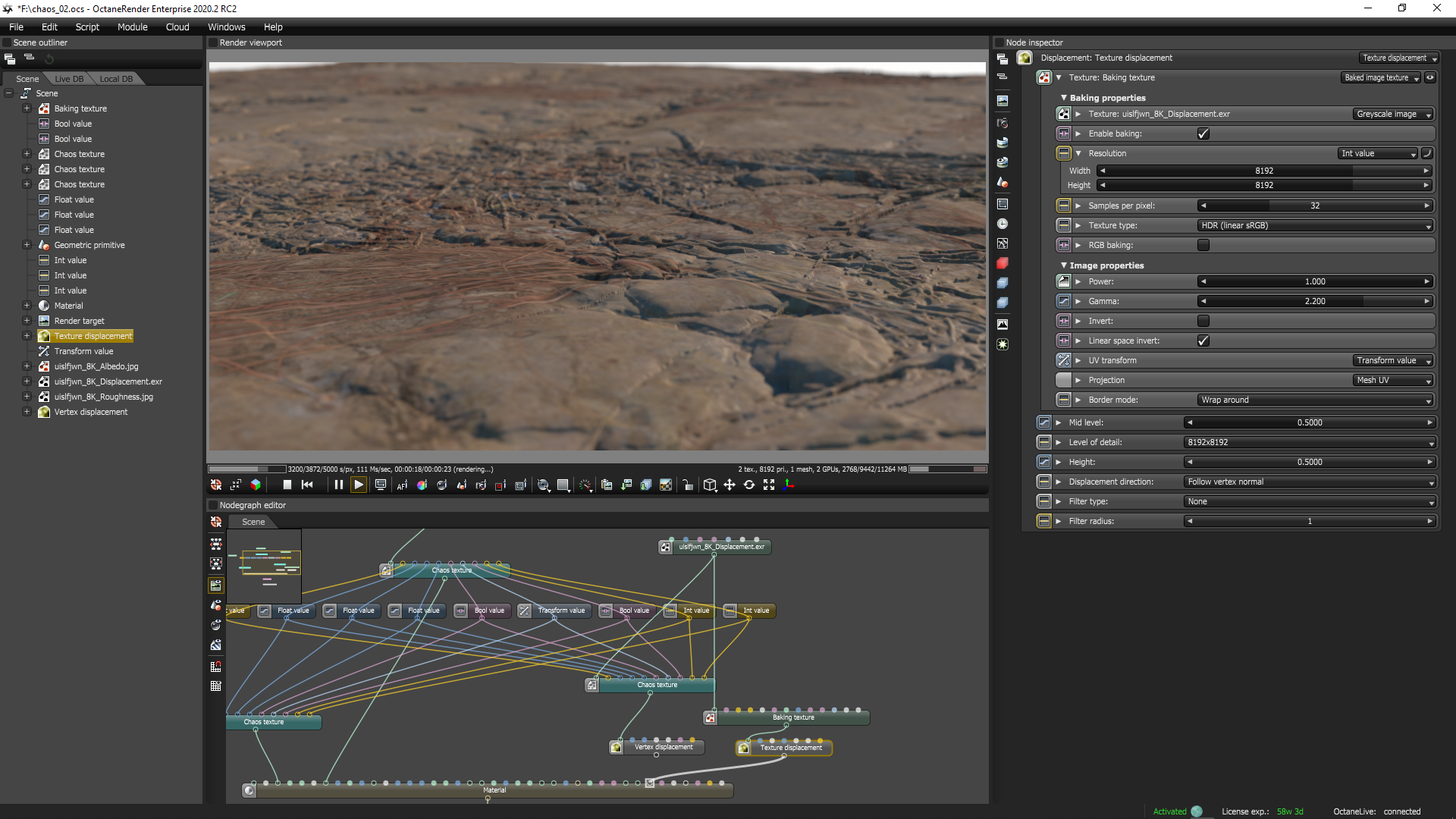

Chaos node is still not "friendly" with HDR images:
Connecting the Image node to the displacement directly works as expected:

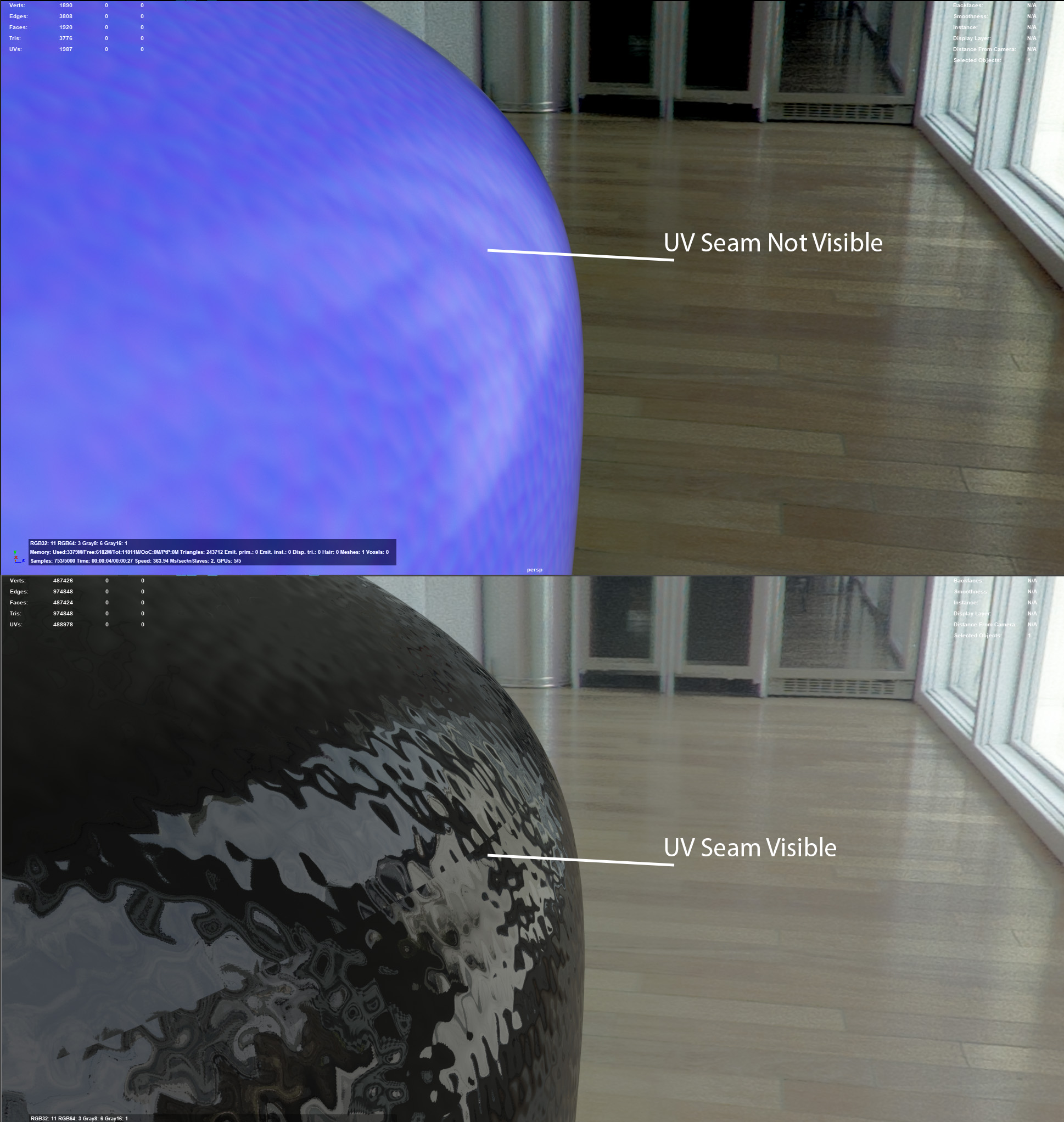

There seems to be an issue with triplaner and normal map maybe? I can't quit figure out what is going on but I'm getting UV seams showing in a normal map that don't show up if I assign that normal to a diffuse instead.
wallace
Posts: 194
Joined: Sun Dec 18, 2016 10:38 pm
itsallgoode9 wrote:There seems to be an issue with triplaner and normal map maybe? I can't quit figure out what is going on but I'm getting UV seams showing in a normal map that don't show up if I assign that normal to a diffuse instead.
Are you able to post an orbx of the scene? Thanks.
