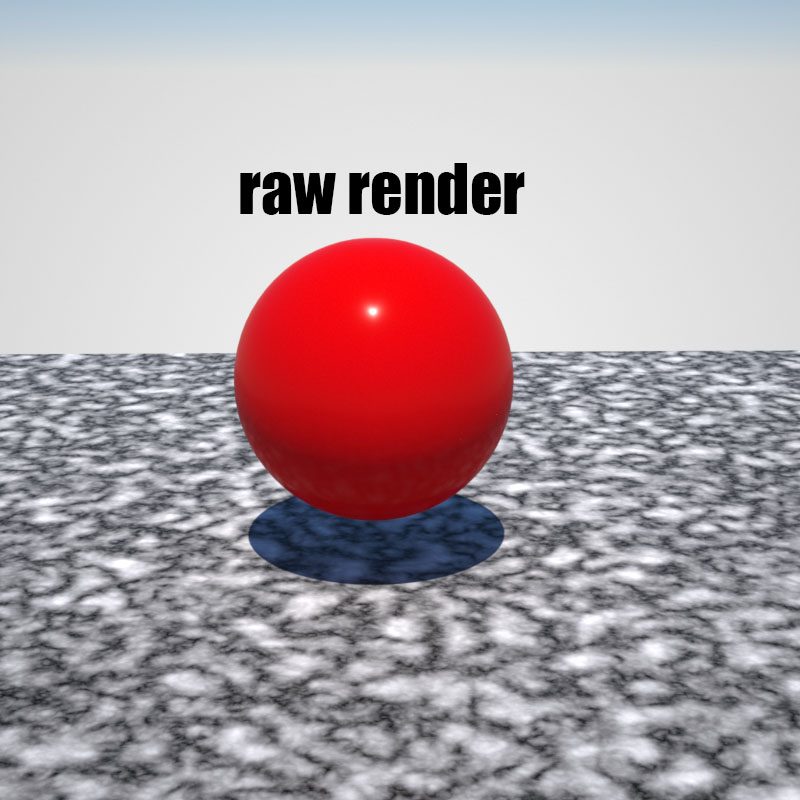

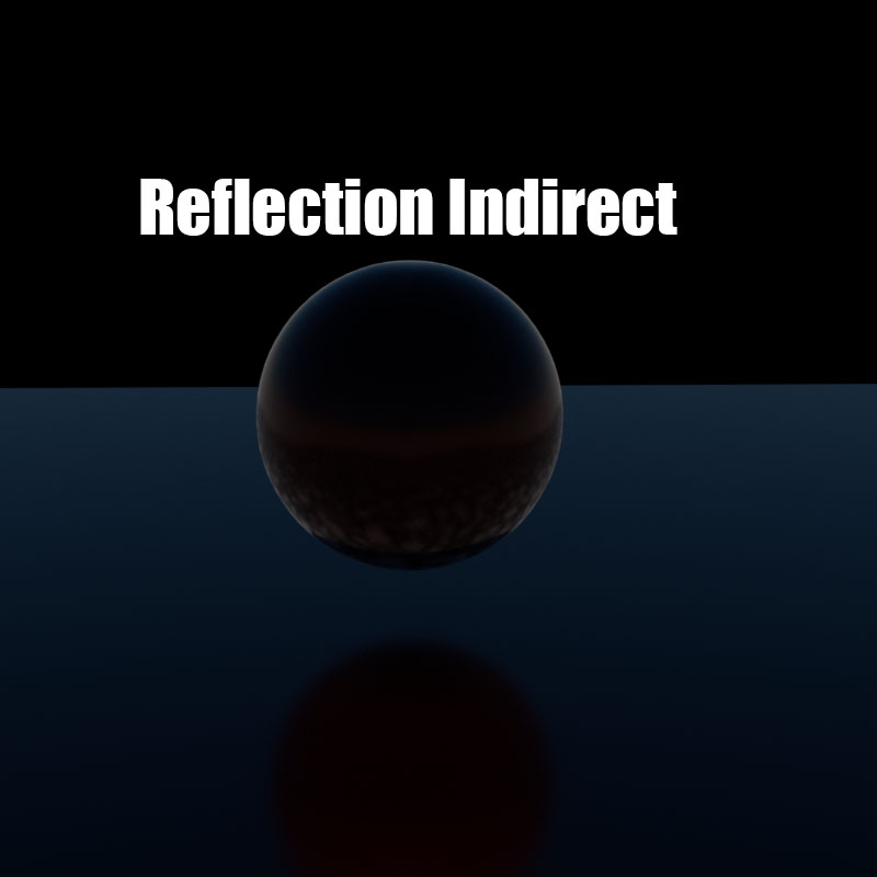

Hi All,
I was testing this last version. And I found something strange. When rendering the reflection passes, It is rendering without any color information. I am attaching a scene for testing.
Is this a bug?
Thanks,
Saulo
Is this a bug?
Thanks,
Saulo

Hi,sauloarruda wrote:Hi All,
Is this a bug?
Thanks,
Saulo
This behavior sounds good to me. The red color comes from the diffuse component, not from the reflection. In the glossy material, the reflection color comes from the specular parameter.
Thanks,
-Juanjo

- sauloarruda
- Posts: 59
- Joined: Tue May 13, 2014 2:56 pm
thanks Juanjo! With your explanation makes sense to me now.
