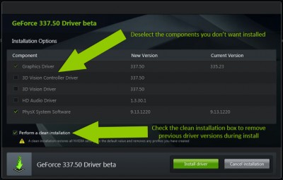

Hi Arash,
it seems that latest Nvidia drivers are not very stable with CUDA.
Please, perform a clean installation of 382.05 drivers or similar, if possible.
ciao beppe
ciao beppe

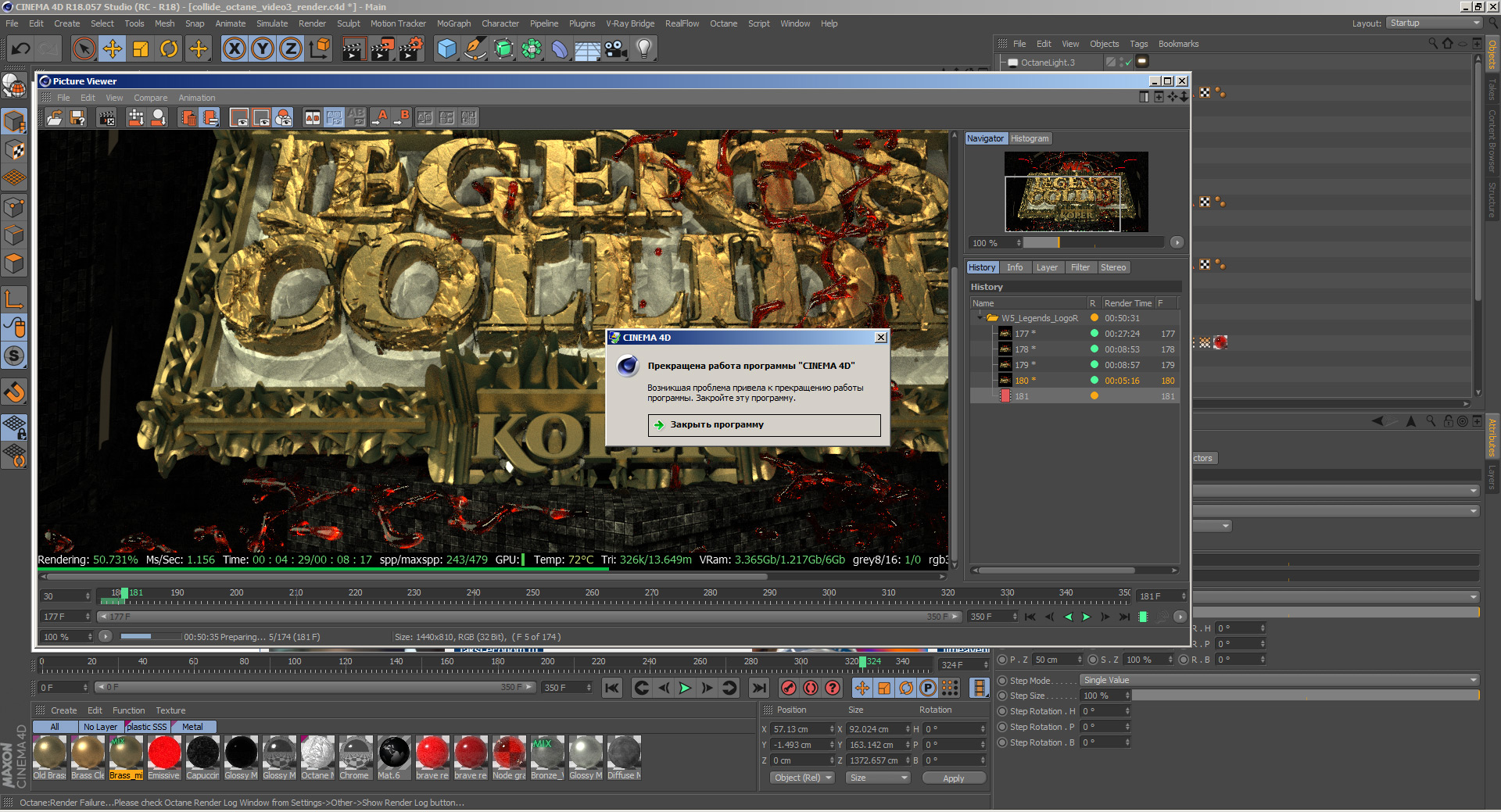

Hello, need help
Also getting a crash with the same scene which were rendering fine few weeks ago.
One frame renders ok, next one starts and after I get an fast black screen (probable my Nvidia Gtx1060 turns off) and Cinema crashes.
Reinstalled nvdia drivers as written above, ver 382.05 installed right now, nothing changed
Bugreport attached.
Please help, I am kinda in a rush on this project.
(Win7, Cinema 4D r18, nvidia gtx1060)
Bugreport attached.

Hi tony_acrid,
from your bugreport, the Nvidia drivers installed are 372.70 (372.70), so please, perform a clean installation of 382.05 drivers: ciao beppe

Just checked evertything again. Cinema4d crashs without writting bugreport, thats why I sent an old one.
For now I reinstalled 385 drivers with clean installation.
After crash I got an text in Cinema - Octane failed, check octane log
Here is it -
Started logging on 26.08.17 19:44:45
OctaneVR 3.06.2 (3060200)
CUDA error 100 on device -1: no CUDA-capable device is detected
-> failed to initialise CUDA driver API
Scene created in plugin version -1
I attached the printscreen, so you can see that Octade have rendered few frames just fine.
I tryed different Octane render settings, just getting the same crash, but if I make the quality higher it could render not 4 frames before crash, but only 2-3..
Temperature of my GTX1060 is ok, about 70-72 degrees.

You may have a corrupted graphic card. Or alternatively try some older drivers.tony_acrid wrote:Just checked evertything again. Cinema4d crashs without writting bugreport, thats why I sent an old one.
Here is it -
