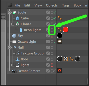

1. Open the Live Viewer Window for Octane in C4D
2. Option-click the visibility of the layer highlighted in green (neon lights’ layer) and set to off (both dots red) (see attached screenshot), C4D will crash every time.

You're not Option-clicking the neon lights layer, you're just clicking it. If you Option-click it, both dots change at the same time.
However, it doesn't appear to be crashing on your system. If it still doesn't crash when you Option-Click, what else can I do?
