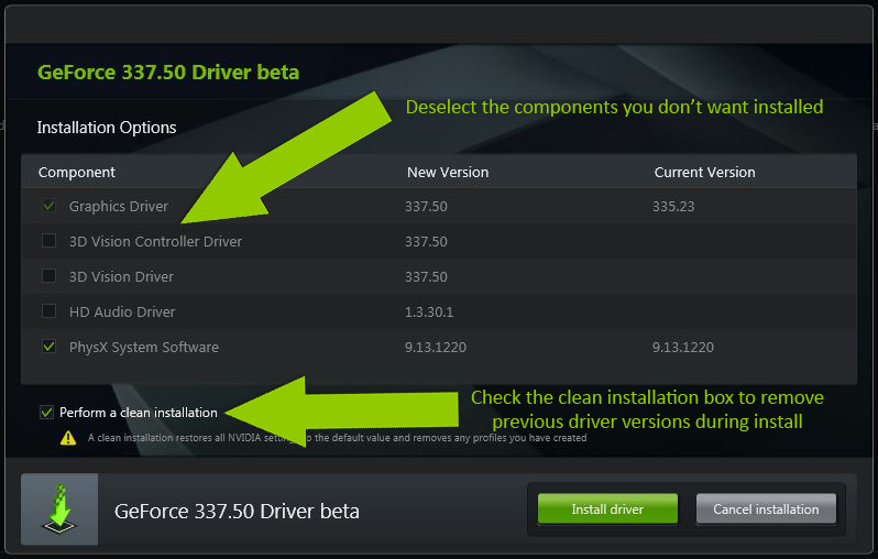

Hi Arash,
it seems that latest Nvidia drivers are not very stable with CUDA.
Please, perform a clean installation of 382.05 drivers or similar, if possible.
ciao beppe

Posts: 10615
Hi tony_acrid,
from your bugreport, the Nvidia drivers installed are 372.70 (372.70), so please, perform a clean installation of 382.05 drivers:
ciao beppe
tony_acrid
Posts: 6
Joined: Sun Aug 20, 2017 1:22 am
Just checked evertything again. Cinema4d crashs without writting bugreport, thats why I sent an old one.
For now I reinstalled 385 drivers with clean installation.
