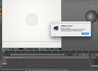

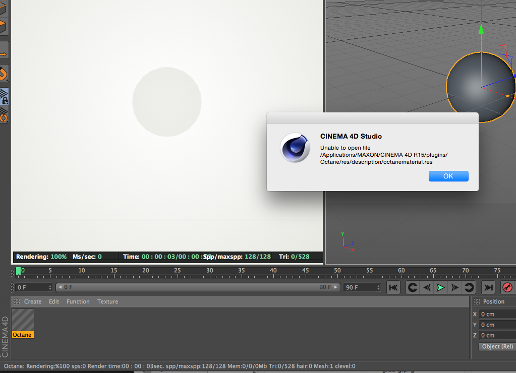

hi aoktar thank you for the hard work
i just install the new 2.16 and when i try make new material i get this message
try with 2.16.schodt wrote:OK so I just tried to save out some materials from standalone (v 2.15) again, and save them in the localDB. This results in that c4d closes whenever I click on the "localdb" tab in the liveDB window. I've attached the livedb folder from my prefs folder here.
Thanks. Can you see any files in "res" folder in c4doctane? It says that cannot open or found *.res filesalbehany wrote:hi aoktar thank you for the hard work

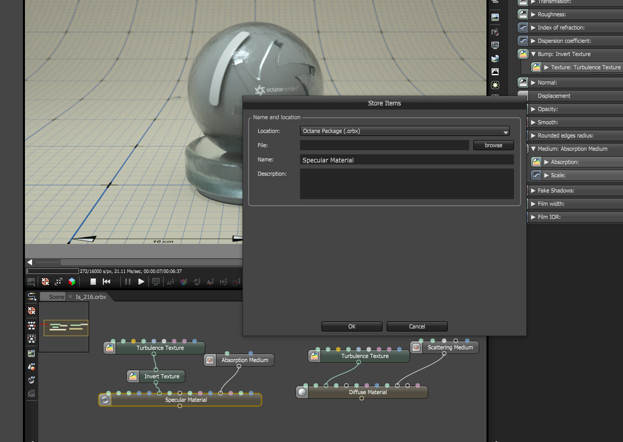

I'm just trying to get the materials
I actually tried saving the materials via. Standalone first by saving it in the localDB(which didn't work), so I tried importing the ORBX file, but it isn't working either.
EDIT: OK I finally got it to work by grouping the material along with its nodes in Octane Standalone, right-clicking and saving the material it self as an ORBX file. Saving it to the localDB still makes C4D crash.

do this way. Select material and save as orbx. Then import and voila...schodt wrote:I'm just trying to get the materialsI actually tried saving the materials via. Standalone first by saving it in the localDB(which didn't work), so I tried importing the ORBX file, but it isn't working either.
