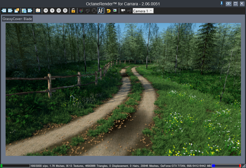

SciFiFunk wrote: HF Country Lane. open OVP get an error "The scene is too complex and could not be loaded into Octane. Please reduce the complexity of the scene and try again". Carrara is up to 5GB memory (I have an 8GB machine) so fits ok (80% space usage) - although the whole thing is sluggish. It will render in Carrara native, the ovp reads 52/2536/3221 as memory usage.
Please let me know if I can supply any more useful info to solve this.
Steve
I've tried that scene in both 8.1 and 8.5 without a problem on both my Titan and 580. Peek system memory used was around 5.3GB. The scene easily fits into Octane so I don't know why you are getting the 'complex' message which means that the Octane API failed to load the scene. I don't see any errors in the log

HF Country Lane in Carrara 8.1

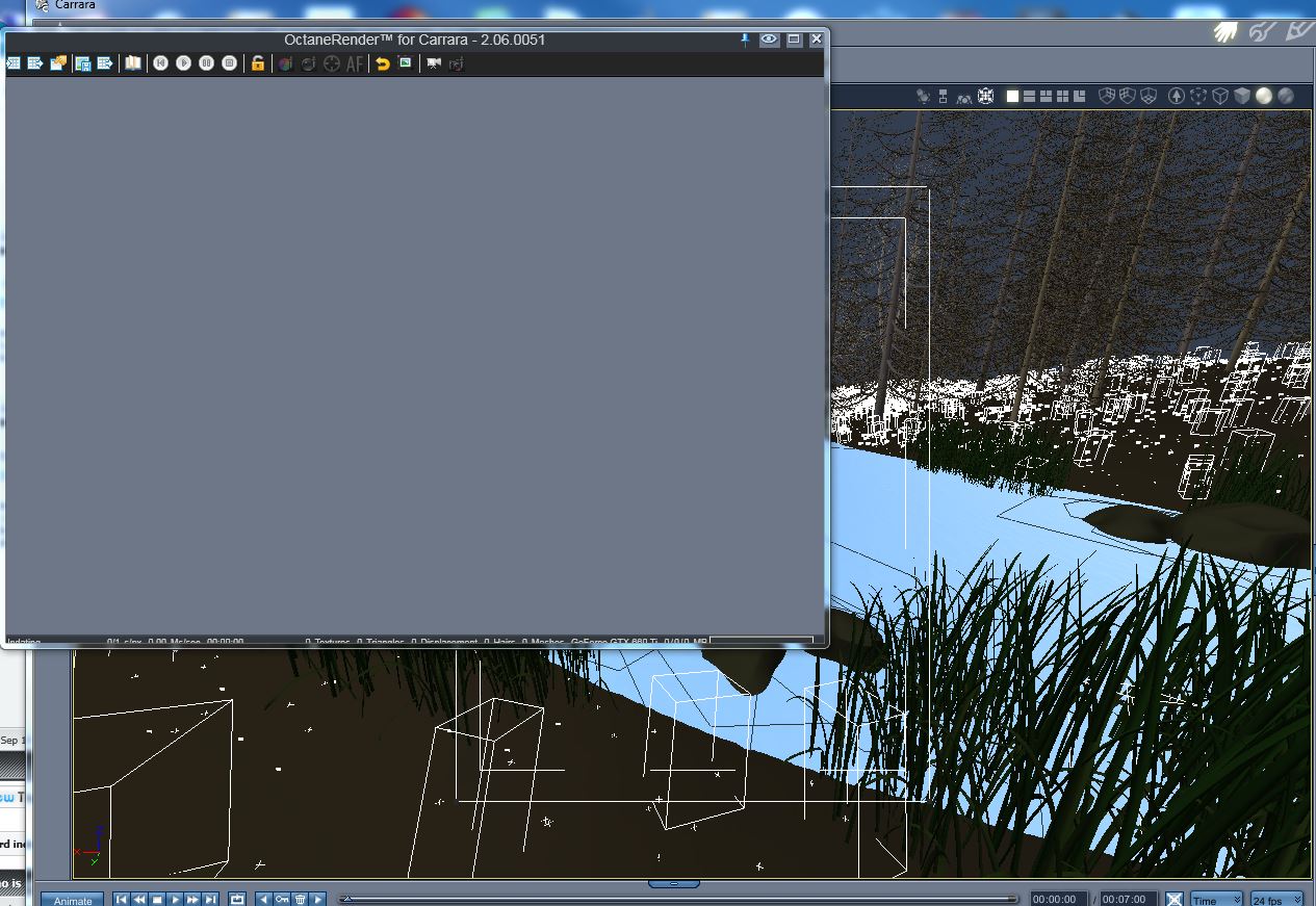

I have cleared Carrara's cache folder. The system has 16GB RAM a GTX-480 1.5GB and a GTX660Ti 3.0GB this is what happens when I load Howie's scenes into Octane.
The System sits on the loading or compiling screen then it eventually crashes Carrara
