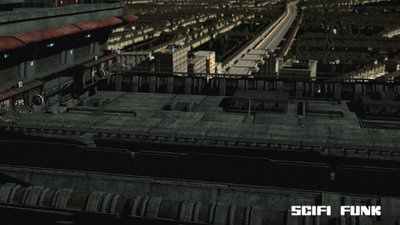

Squeezed in enough time to test out two of my largest scenes. Both work. Not the best render below (lack of time) but it WORKS!
This scene almost cripples Carrara btw, Octane plug in handles it just fine.
More testing on monday.
p.s. Those houses are not a backdrop btw - they are individual and detailed houses. (detail removed from some to save space)
