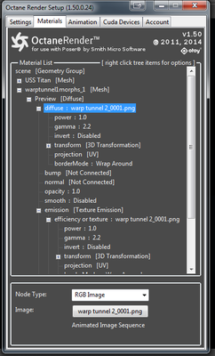

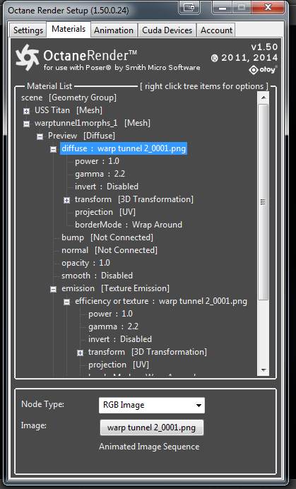

Its still not working. does the files format matter?
When you load the image, does it give you the "Animated Image Sequence"?
spartan00j
Posts: 357
Joined: Fri Sep 27, 2013 1:27 am
yes it looks like that.

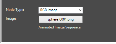

What does "stopped working" mean pls? Is the image showing up as "Animated Image Sequence" in the material tab?
Can you post the octaneplugin.log file resulting from rendering the animation pls?
Paul
spartan00j
Posts: 357
face_off wrote:What does "stopped working" mean pls? Is the image showing up as "Animated Image Sequence" in the material tab?
Paul
okay I see it only shows the animated sequence when rendering. Okay sorry about it. i didn't know.
